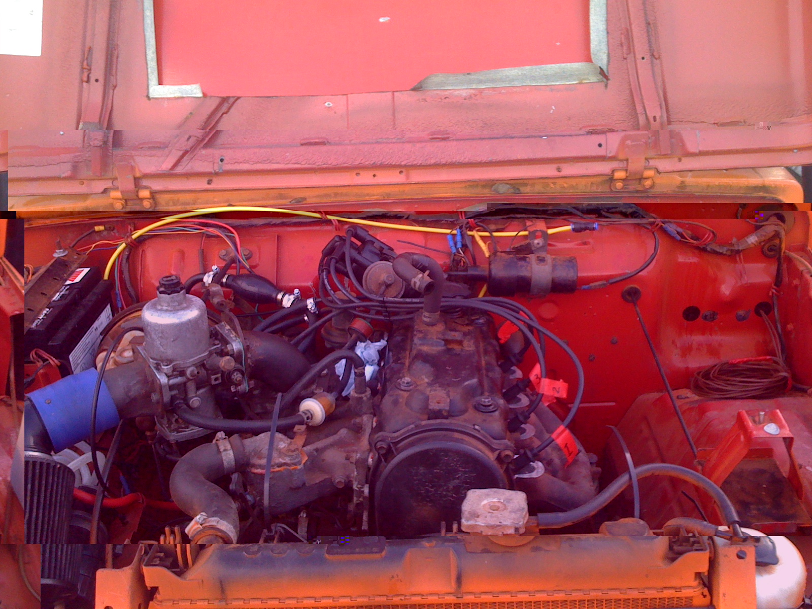

Just bought a SJ413 with a 1.6 8v vit engine with HIFF44 Carb fitted but need a throttle cable for it, the guy i bought it from said i would need a bespoke cable and mention 12" longer any ideas what will fit or will i need a custom cable made?

Go to halford etc, get a bike (any) brake cable. The one end will have the right fitments for the throttle pedal and the other will be loose and can be made to fit the carb. I got one for about £4.
