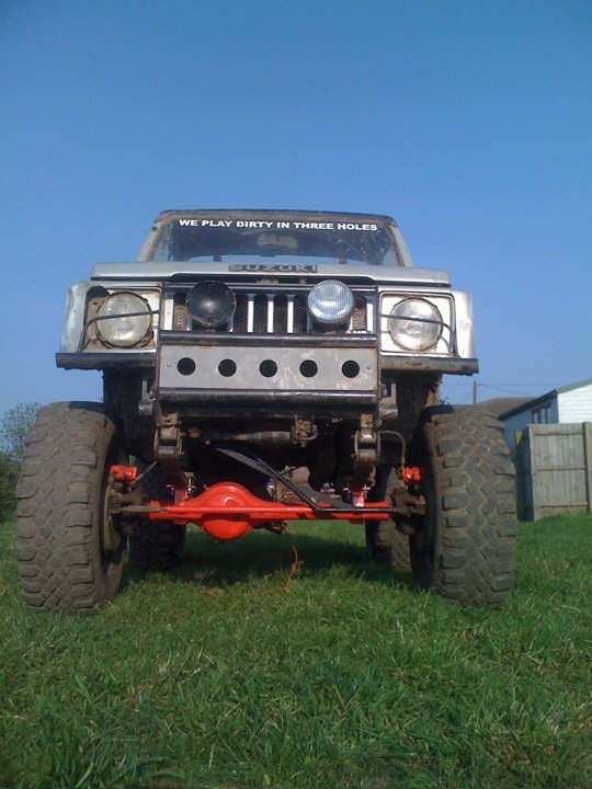

front bumper made from scaffold bar and the old ball bar
spring over axle
iv added leafs in
welded rear diff

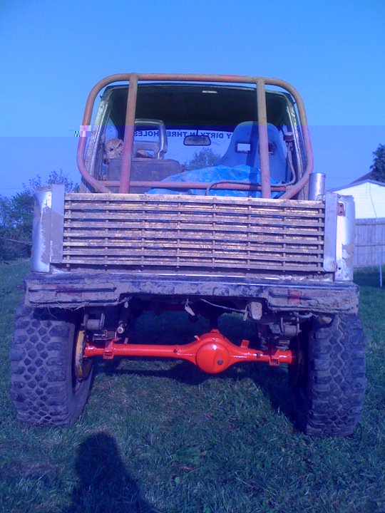

bucket seats ( not fitted yet)
rear cage ( front sections half done

waffle boreds are now tale gate
all fuel tank
hard top roof welded on
old talegate now bulkhead

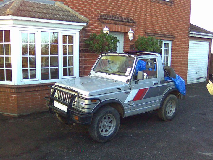

when i first got her

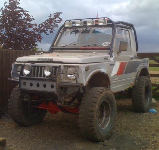

roof
roof

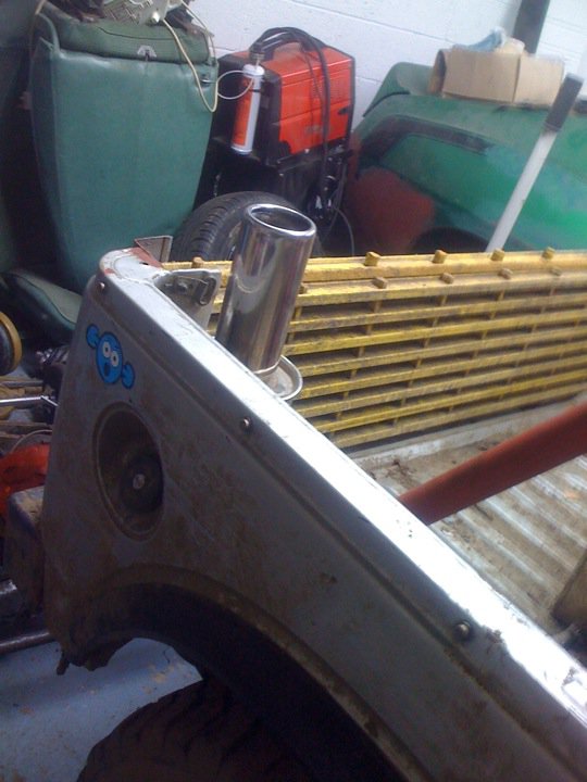

exhaust haha
exhaust haha
once lifted but still smaller tyres

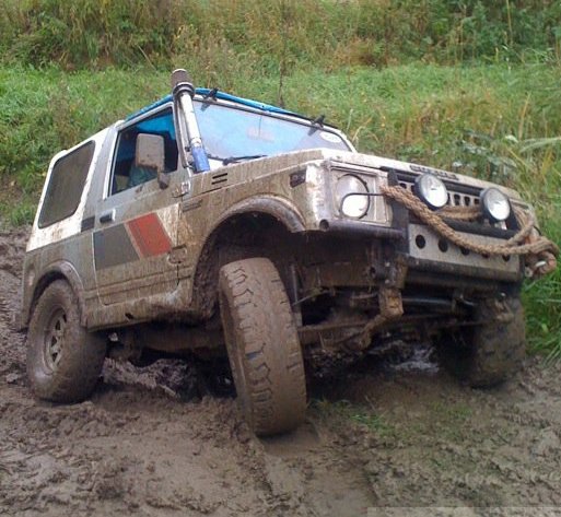

how it sits today :)

it looks like you've used your SJ hard! does the exhaust get really hot? it might have been better to put it on the other side (away from the fuel tank filler)

yer iv used it :) but thats y i bought it its ok its got an alli tank in th middle out of the way i did have the filler as my exhaust for a while but i was given the exhaust to use :)

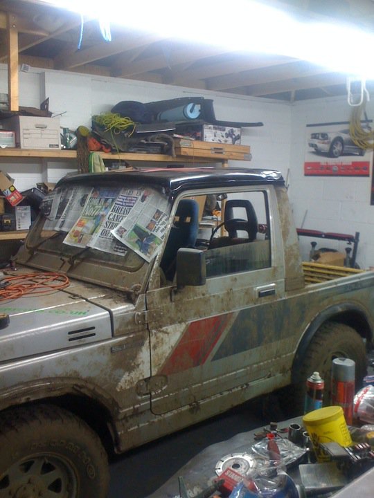

temp hard top till i decided to cage it :)

got the front cage all welded up this weekend including spot brackets rear working light n cb mount just gotta paint it all up so it can go back on :)

Post by arnie » Sat May 14, 2011 8:03 pm
roll cages it all done :) well pleased
Posts: 11703
Re: zuke sj410 budget home build
Post by ScottieJ » Mon May 16, 2011 4:04 pm
Nice work on the cage matey :thumbup: does the front hoop just bolt to the scuttle or do you have tube running down to the chassis from underneath thurs scuttle? If not I would recommend it, a mate of mine has a nice dent where he rolled it and the scuttle isn't strong enough to mount a cage to.
