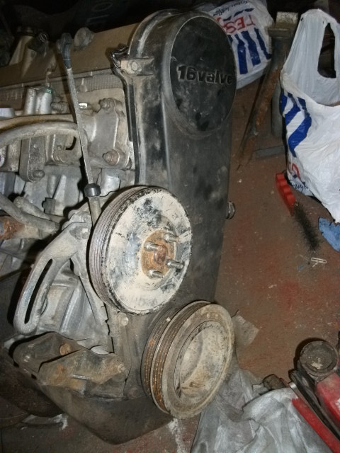

I thought I would actually do a thread about the 16v engine so here goes!
I got the engine off Tim Pink, who had already done a lot of the work to put it in!!!

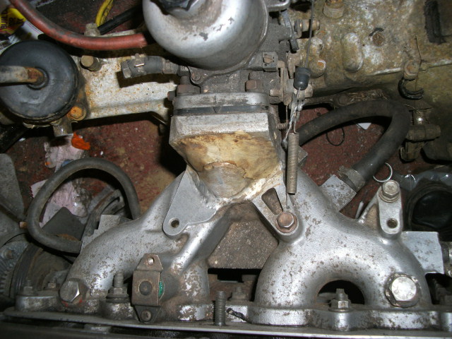

He's already modified a swift manifold to fit with an SU...

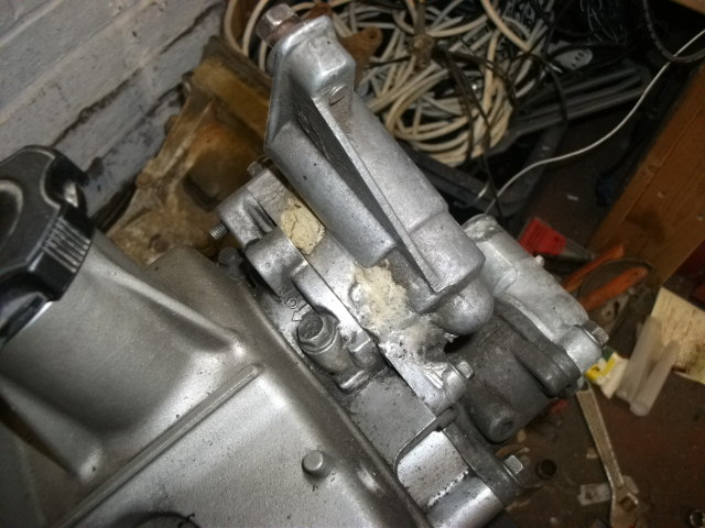

... and modded the distributor housing to take a standard Sammy dizzy...

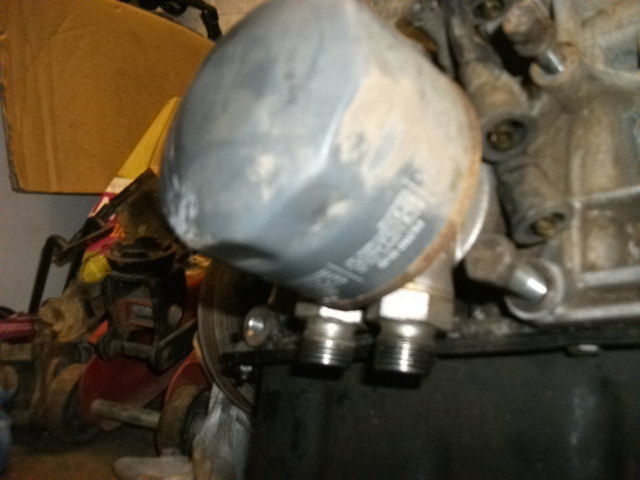

Noticed yesterday that the engine is fitted with an oil cooler attachment, so it looks like I will end up running an oil cooler! :)
