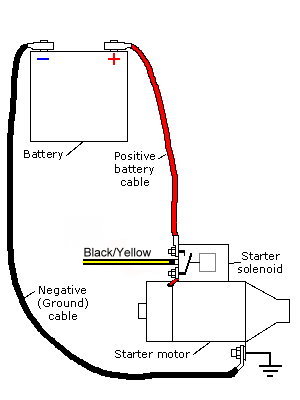

Hey, just wondering if any one could tell me where to wires go from the starter motor?? Thanks again
Adam

Re: Non starter
This is the samurai/413 way but I think 410s are different
The big chunky wire goes to battery +ve
The tiny wire goes to the battery light on the dash, then to the ignition
Re: Non starter
What colour wires are you trying to find a home for ?just wondering if any one could tell me where to wires go from the starter motor??
Black and yellow goes to the starter switch and via a diode the ignition coil.
Black and green goes to the ignition coil but where it connects on the starter nobody seems to know
Fat lot of help that was

The live wire that engages the starter motor onto the flywheel, where does the wire connect to?
When my anus was rolled this wire was ripped out and dont know where it should connect to.
adam

Re: Non starter
Black with yellow tracer is the trigger from the ignition switch.
- starter.jpg (19.93 KiB) Viewed 6335 times

Re: Non starter
Thanks darrell. I will wire that up this week

Re: Non starter
I have the sj running, it was a red square pleg behind the dash on the passenger side that had come loose. Noticed this when took window screen off as im preparing the sj for a new paint job. Any suggestions on paint type colour etc
