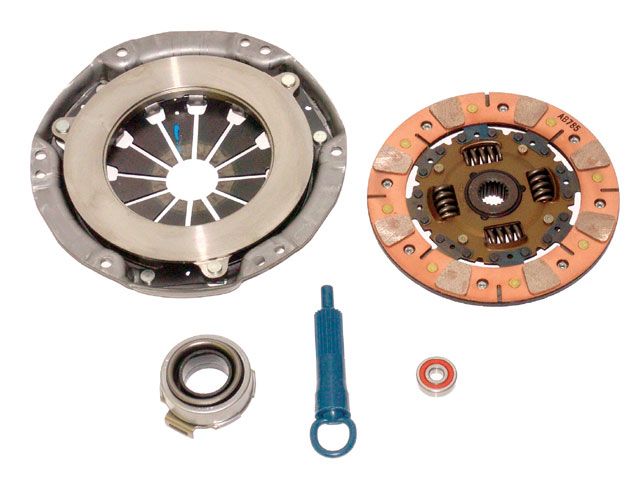

Why don't uk suppliers have an alignment tool in the clutch kit like many of the usa suppliers do. It's only plastic so wouldn't cost much, I'm sure most of would be happy to pay an extra couple of quid for it. This kit even comes with the pilot bearing. When I fitted mine I replaced the bearing but the gearbox shaft was slightly worn so it's a loose fit anyway :cry:
