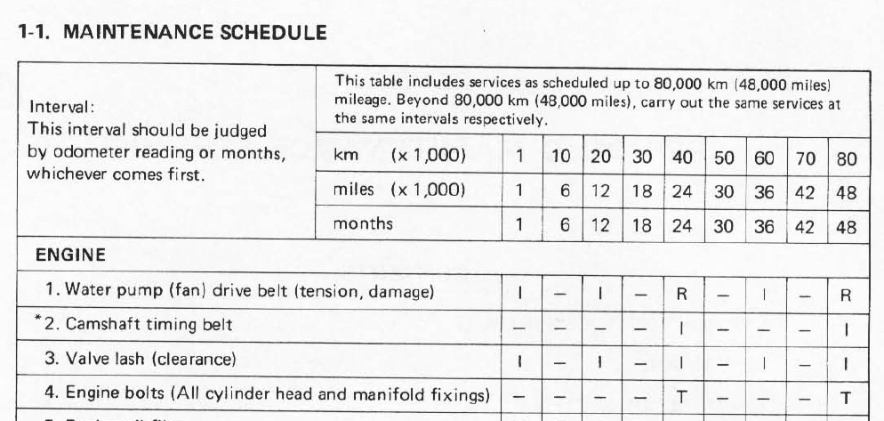

Hi :welcome: to the club. My workshop manual only states to inspect and replace when necessary.

First off Hi and :welcome: to SCUK
Its a non-interference engine so no damage will be done if it snaps. Just a bit of down time while you replace it.
On the other hand its nice to have the peace of mind its not going to go when you least want it too.
