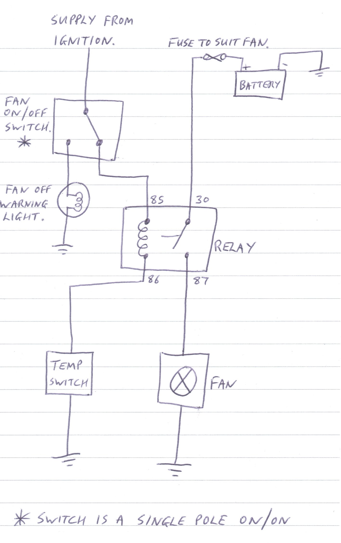

If your planning on going offroading with it , it may be worth considering wiring an off switch for the fan. Just to stop it showering the engine bay in deeper water. However I would wire a light on the dash to warn you it's off. Something like this--
Fan circuit.jpg (199.69 KiB) Viewed 9697 times
Not one of my best diagrams :oops:

thanks for that darrell, i wont be doing any deep water offroading, just a bit of greenlaning maybe..
but i like the idea, i might do it so i know when the fan is on and working, without the switch...
