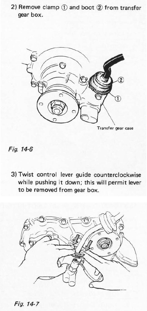

any one got pics to show how to remove selector from t/box? problem i have is seems to be stuck in 2wd and i cant shift it.

I had that problem, when i got range change lever out i found plunger end of 4wd warning lamp switch jammed in selector track.
Transfer box lever removal.jpg (86.65 KiB) Viewed 4899 times

steve, i hope thats all my problem is.
darrell, cheers for the link, so easy when you see it like that.
