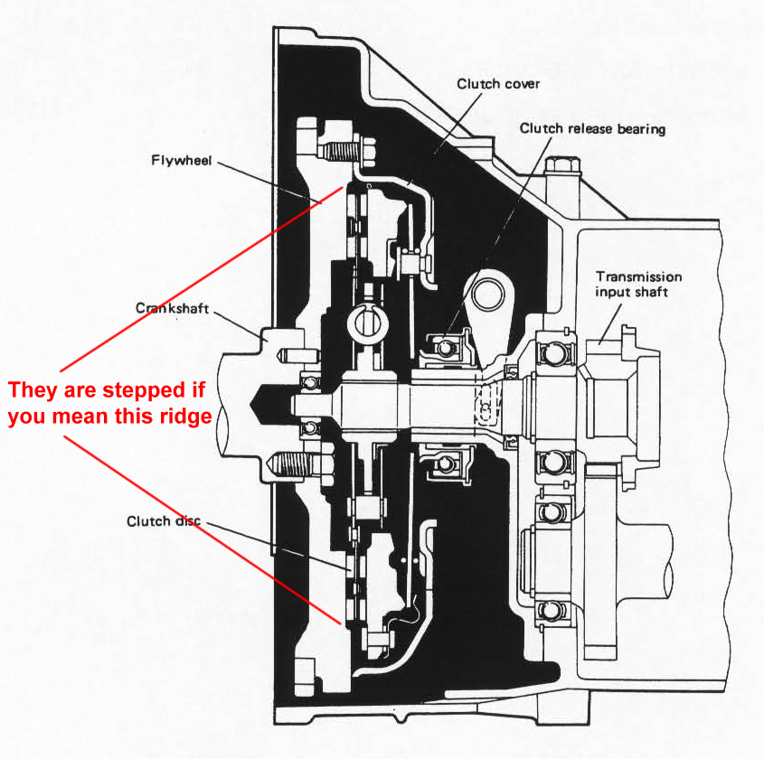

Clutch was slipping so pulled it all apart. Clutch plate is down to the rivets so thats obvious.

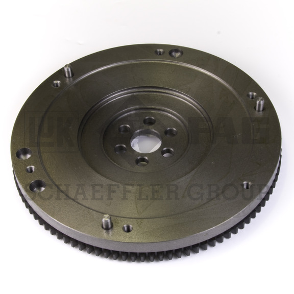

However, how much wear is ok on the flywheel. Should it be flat because if it should then mine is shot.
Its about 2mm deeper where the plate rides than the outside.
Do i need a new flywheel?
Cheers
Re: Flywheel wear???
Post by Darrell » Wed Mar 06, 2013 7:11 pm
It should be flat where the clutch friction plate touches. (clutch disc in diagram).

Thanks for the second photo, mine is looking ok after seeing that.
