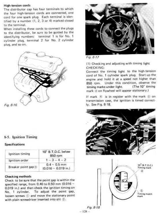

Do you not have the timing marks on the flywheel, under the rubber bung on the gearbox housing ??
- 410.png (314.49 KiB) Viewed 10279 times

That's really helpful thanks, however now I have top dead centre, how do I know where the cam shaft should be at the point of top dead center?

OK another marking query, when rotating the fly wheel there are a few marks as indicated in the picture above, but someone before me has gone paint crazy and made it nearly impossible to see where the TDC mark and the 10° BTDC is. From the first mark on the fly wheel, how many lines is it till TDC, or how many degrees does each indicator represent?
