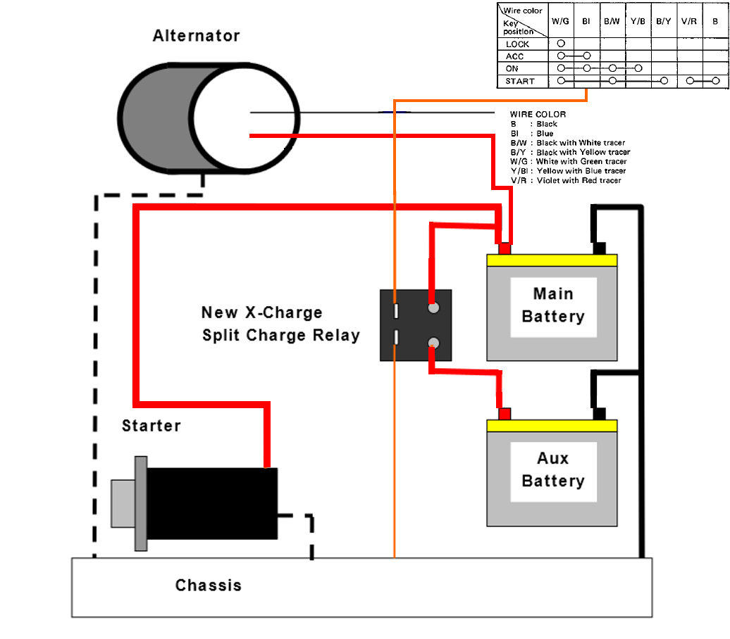

http://www.x-eng.co.uk/instructions/new/x-Charge.pdf
Well I read that to be fitted like this
split charge.png (79.5 KiB) Viewed 6966 times
However I don't under stand how it works.
IE: I get the idea the relay is not energized when starting as the linking cables and relay could not handle the starting current (if the main battery was low).
Assuming you connect the winch to the aux battery and winch whilst the engines running (relay energized) , what happens when that battery gets low. What stops it from drawing the full winch current from the main battery. The wiring won't handle this ???

Had another search on the subject and as both batteries are connected together when running they would discharge equally.
IE: if your winch is drawing 300amps and connected to the aux battery - 150amps would come from the aux battery and 150amps through the split charge from the main battery.
I can understand that but would still worry about overloading the split charge relay and wiring.
If/when the aux battery gets old/tired more current would go through the split charge.
I think that diagram would be ok but I would fit at least one large fuse in the link wiring so as not to be able to melt it.
Personally I think split charge diode units are good. OK your using the winch on one battery only, but at least your main battery will still run all the vehicle.
Hell, what do I know, I don't have a winch ;)

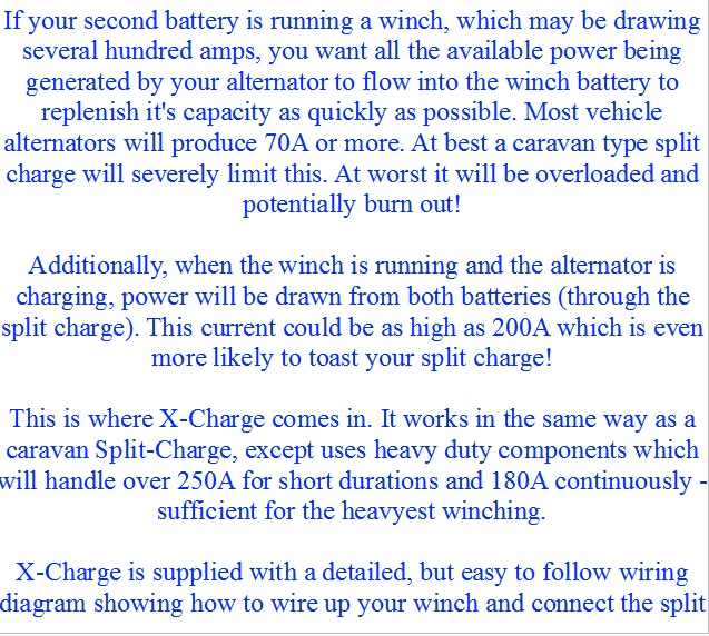

Info from x-charge seller
x charge info.jpg (211.33 KiB) Viewed 6946 times
I guess it depends on the rating of the relay you have and cable size used.

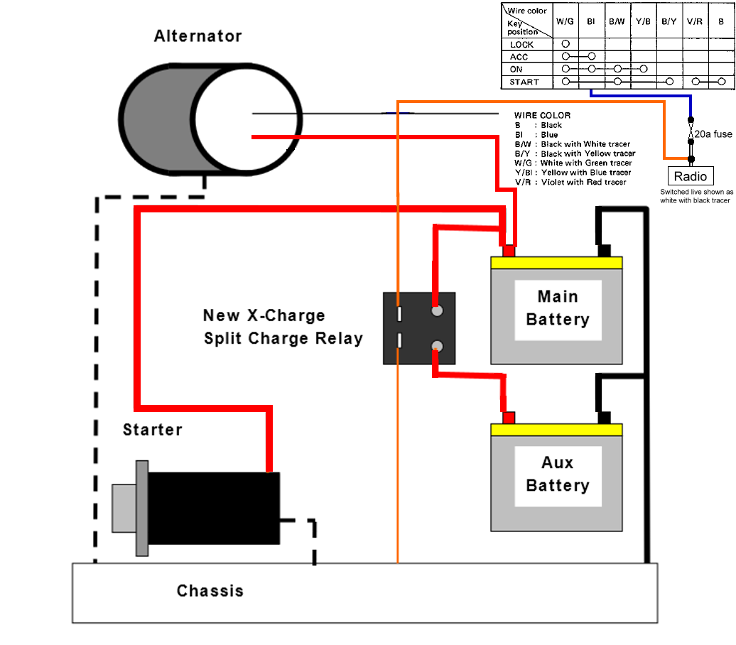

Post by Darrell » Sat Mar 16, 2013 5:34 pm
plugspanner wrote:thanks
the cable is between the batteries is 35mm sq and i have a 200 amp relayThat's good, 35mm sq is rated at 240A :thumbup:
I still do not know if i have a voltage sensing alternator though It's got a regulator so connect it to the radio wire as they recommend
also where does the inline fuse go?I would fit a large one on the relay large wire for peace of mind (but they don't show one, so that's your choice)
is it between the live and relay? As the energising feed is the radio wire, it's already fused :thumbup:
all the wirng is done except the small wire live feed to the relay, just need to connect that and we should be there.
my sons sj twin battery set up was wired up by a local suzuki bod so i just followed his pattern, his sj is a 1.6 carb vit engine, but do not know what alternator he has as yet.
thanks
shaun
So the workshop manual shows the radio switched live as "White with black tracer"
So here's another diagram.
This info is from the 1994 print manual as it's the only Vitara one I've managed to get. I hope the radio wire colours haven't changed as yours is a late model.
If they have ,time for a multimeter..
split charge.png (85.94 KiB) Viewed 6930 times
You could wire it straight from the ignition switch as my earlier diagram, but I would also add a inline fuse if you do.
Hope that's it :thumbup:
