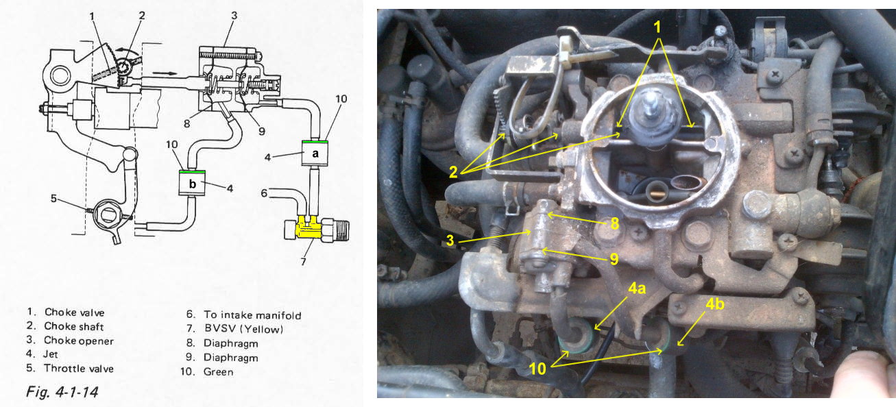

Looks like the auto choke doesn't work , so somebody has tied it open-off.
Split vacuum pipes can cause this not to open on warm-up depending on which ones are knackered but the wax element should still open it when hot. (Maybe not without help from the vacuum side
The hose is just "vacuum advance hose" available at any half descent motorist shop.
Much more info is in the link I posted earlier.
Hope that's what your after

Any excuse for a diagram while I'm having a cuppa!!
- Autochoke diagram 1.jpg (156.26 KiB) Viewed 5383 times

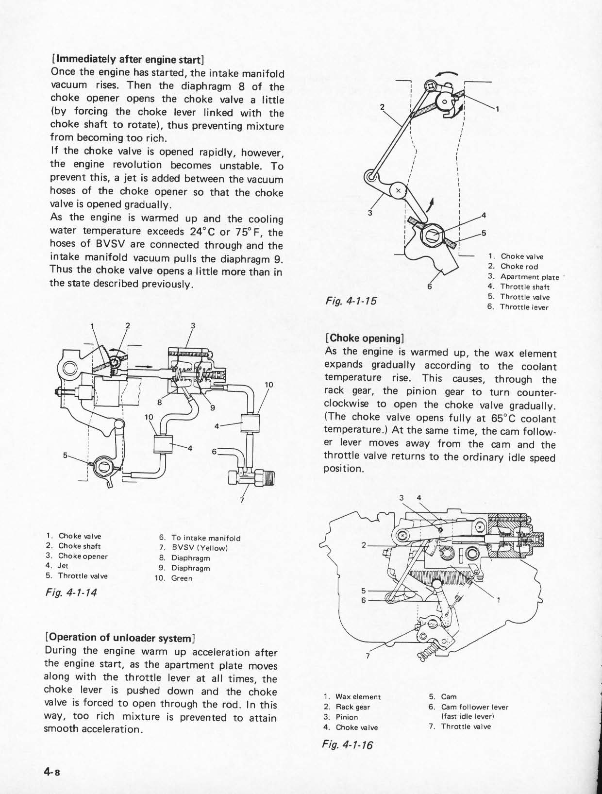

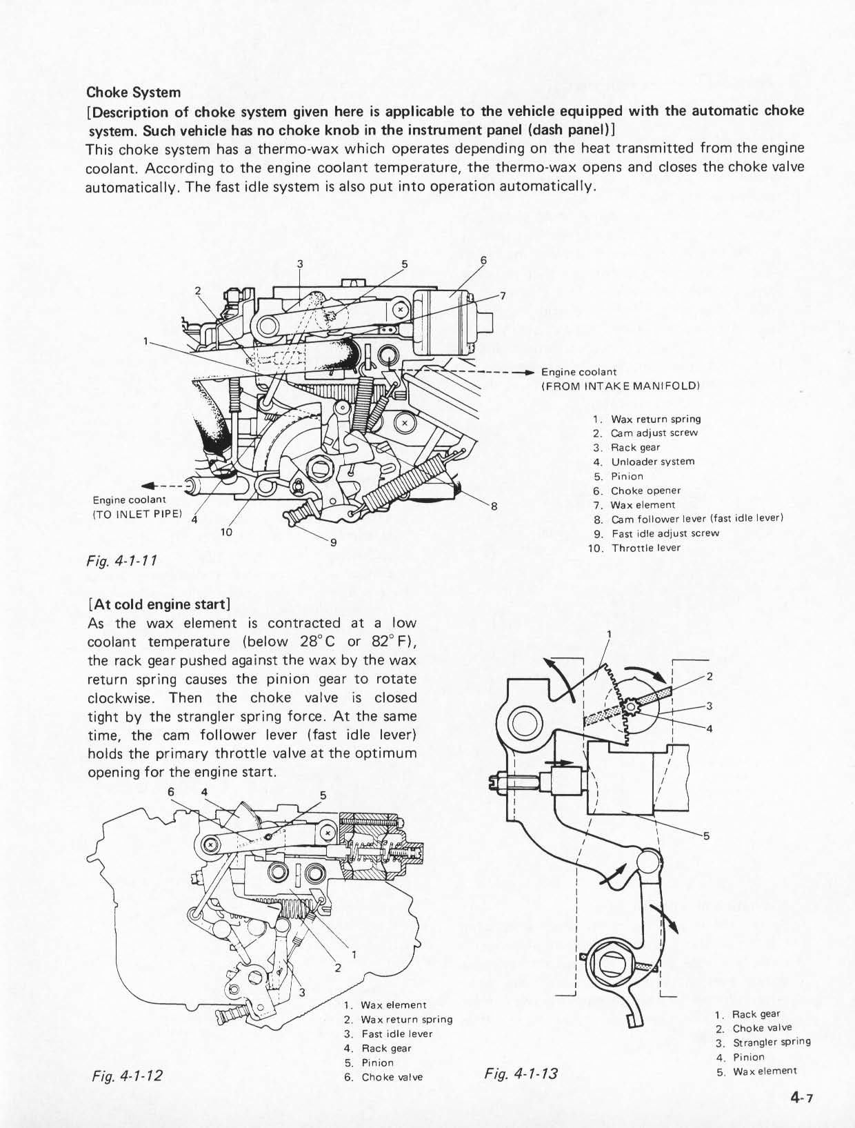

Relevant section robbed from the manual
- choke 2.jpg (366.41 KiB) Viewed 5368 times
- Choke 1.jpg (346.67 KiB) Viewed 5368 times

I may just leave it for now then,I,ll replace pipes as some are a bit tatty and perished and see how it goes as when it's warm it runs and tricks over ok
