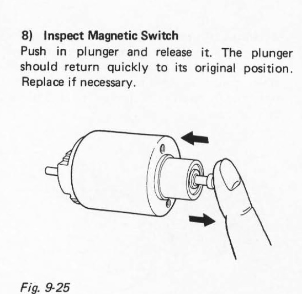

Thanks for the reply, much use! I've stripped it and freed everything apart from the solenoid which I cant see how to free that up?

Post by Darrell » Sat May 11, 2013 1:17 pm
Most of them just pull out (I think :er: )
I've just used fine wet and dry to clean the surfaces.
As long as the plunger moves freely :thumbup:

Got it out. The plunger moves freely and all of it moves now, greased the inside of the 'barrel' as such. But it still won't start....was the grease a bad move?
