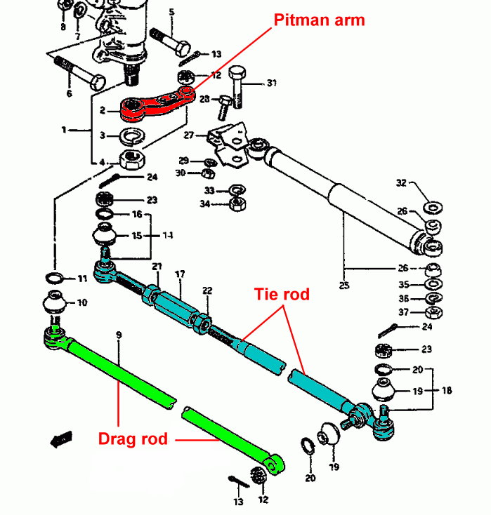

I think a whole new tie rod would be a small fortune or un obtainable.
I think the one on the 410 im breaking is good. Ill check for you tomorrow.

mike harris will have a tie rod
Re: Propper country build (turf the sj)
The only company I know selling them
http://www.euro4x4parts.com/parts/dro11 ... joint.html
Well apart from Suzuki..

dam these ain't cheap ow's me £400 already
know it sounds tight but i wont be spending any more on it i do have a good welder mate tho and some car bits kicking about so the bar might get modded lol unless one comes up cheap.

Put an ad in the wanted section, I'm sure somebody must have some spares. PM mike he's always pulling them apart.
Tie rod keeps being mentioned
but I think it's the drag rod your after.
Just make sure you get the right length
May be worth measuring as old Suzuki's have often been messed with..
- steering.jpg (92.71 KiB) Viewed 6827 times
its defo the drag link its the ball joint on the end looking at that pic i could get a tie rod and mod that to fit..
