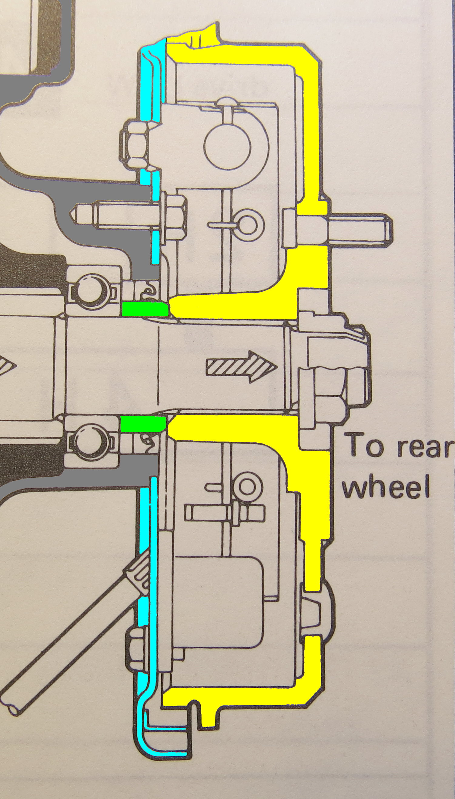

Re: T-box mysteries
Post by Darrell » Sat Jun 08, 2013 10:48 am
Did you use a gasket on the case or just silicon sealant ??
Hope this diagram helps...........
Transfer Brake Diagram.jpg (580.62 KiB) Viewed 5244 times
kiwizook
Location: Masterton, NZ
Re: T-box mysteries
Post by kiwizook » Sat Jun 08, 2013 10:52 am
looking at that diagram, is that green thing supposed to be some sort of shim? might be my mystery shim.
haven't used any gasket yet, just closed the case up to see if it was all working, still got to put some gasket sealant in, it's what was used when i took it apart, so should be alright now, unless I need a proper gasket to free the box up a little now
Re: T-box mysteries
Post by Darrell » Sat Jun 08, 2013 10:54 am
Yes the green bit is the shim/spacer..
Here's a link to the workshop manual http://www.4x4.in.th/manual_sj413/chapter14.pdf
Page 14 gives the case clearances.
I've never pulled one apart so "I Dunno" ;)
