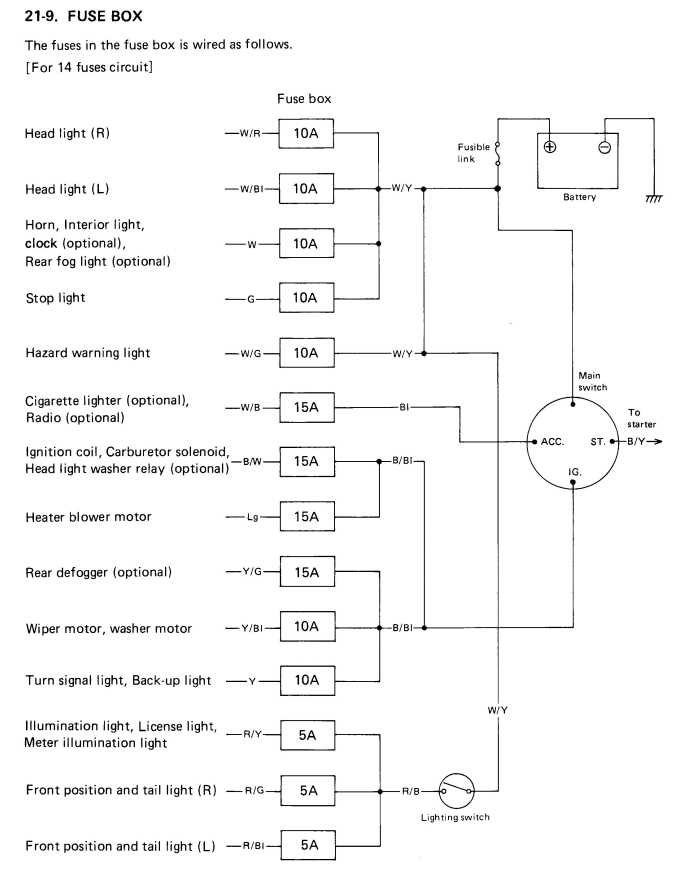

Hi guys, i rather foolishly and without thinking decided to rip out the whole contents on my dashboard..i didnt have an ignition barrel but had an ignition button/switch.... problem is.. i ripped everything out without looking.....now i have bare wires everywhere.....i have got as far as the ignition live coming on but cant get the starter motor to turn over...dors someone have a colour code/wiring guide and what ehy connects to what please?

Here's a start (well if it's a 413!)

Post by Darrell » Wed Jun 12, 2013 10:07 pm
Ignition switch.jpg (10.96 KiB) Viewed 6090 times

hmmm....seem to have lost all electrics now, cant even get the igntion click....is thier other fuses located elsewhere i might have blown?

Post by Darrell » Fri Jun 14, 2013 7:17 pm
Have you checked the fuselink from the battery ??

couldn't see another fuse anywhere m8, where do i have to have wires toget it to fire...i.e......1 earth, 1 live 1 starter motor live?..or is it more compliacated than that?
