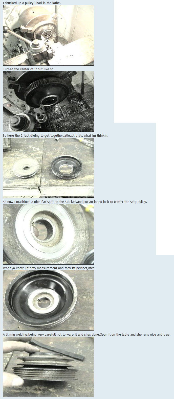

Robbed that pulley info :thumbup: Looks just what you need.
All credit to "rockmike" (wazuks4x4club) for posting it up.

The electric pump looks easiest but if you can just weld another pulley should be simple enough.

Here it is,runs concentric to! i used the water pump/fan pulley from a vitara 16v

Good work :doublethumbs:
Re: vitara pas pulley set up,help needed!
Post by Darrell » Fri Jul 05, 2013 7:06 pm
Very tidy job :thumbup:
