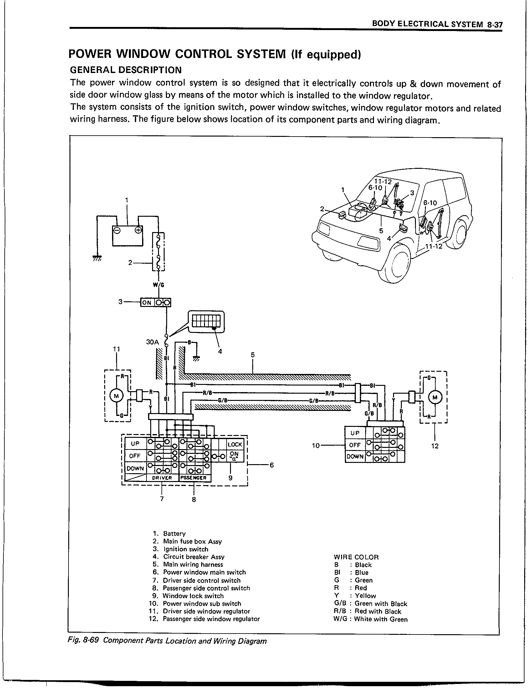

Re: Irritating window problem...
Robbed this from the manual..........
Welcome to the club
No idea where this circuit breaker is located, under the dash looking at the picture??

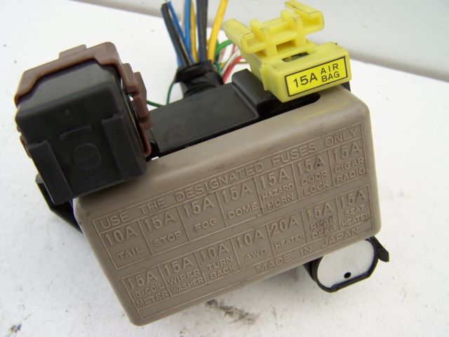

Had a search and found the reset should be a silver disc under the fuse box with a hole in it.
Push something suitable through the hole to reset it. !!
Hope that's correct.
I can't find a Vitara picture, but here's one from a Jimny, so I guess there the same..
- $(KGrHqZ,!qIF!OBdd6LfBQed-grRd!~~60_58.JPG (37.79 KiB) Viewed 7814 times
