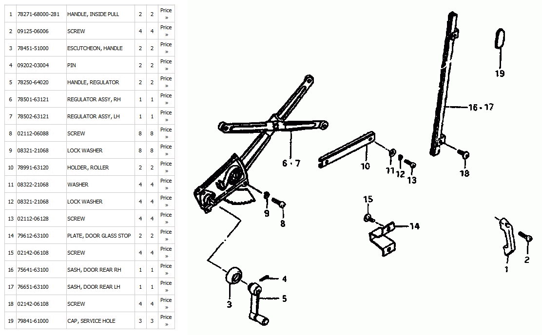

Can't help with any spares, but --
LJ80 window winder.jpg (118.7 KiB) Viewed 10210 times

Post by Bray » Fri Nov 16, 2012 8:48 pm
That's helpful but I'm trying to work out what part 10 is and I guess 16 is the vertical runner.
I took the door cards off and found only passenger regulator in place and both windows held in place with wood screwed along the bottom, so I think I need part 10,16, regulator for drivers side and the runner part that's on the bottom off the window plus some rubber seals.
