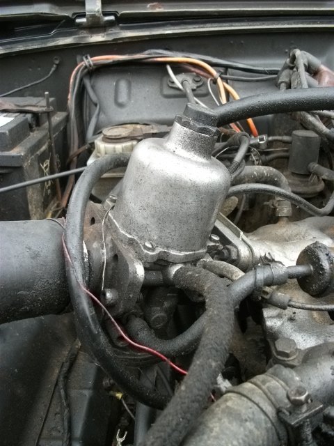

This is what a (slightly dirty) HIF44 carb looks like...
you can visually usually tell which model it is by the dimensions of the dashpot... as lots of the different models and sizes of carb have a different looking dashpot
As said above though, you should definitely measure the throat to make sure... the next sizes above and below are 50mm and 38mm so it should be quite obvious what type it is
