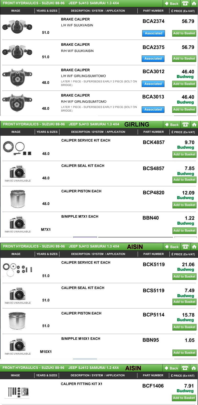

I'm afraid seizing pistons if very common with the aisin calipers. A strip and clean normally sorts it and new seals is a good idea. I have cleaned the piston up nicely with wire wool and WD 40. It doesn't need much for them to seize up. Mine stuck so badly the only way I could remove the piston was to pump the brakes with the pads out and caliper over a bucket, until they popped out
This will show the caliper types.
