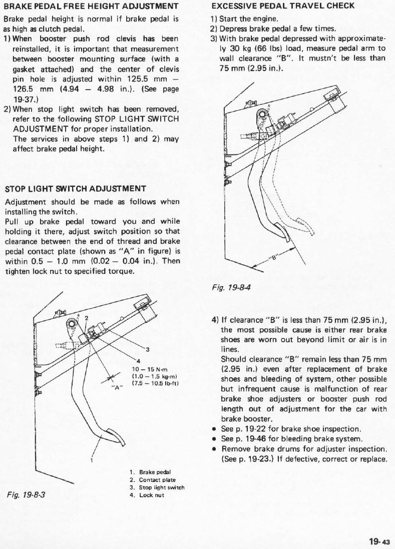

Hi, I want to check the height of my brake pedal, the manual says 130mm from floor to pedal
but does not say where abouts to measure from floor or to where on the pedal, does anyone have
a picture or diagram. thanks

This is from the Suzuki 413 manual
Brake pedal info.jpg (194.1 KiB) Viewed 3709 times
samurai gary
Posts: 40
Joined: Sun Jan 15, 2012 3:19 pm
Re: brake pedal height
Post by samurai gary » Mon Jan 06, 2014 2:12 pm
thanks...
