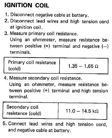

you've tried a new fuel filter i presume? you want to measure the resistance of the ignition coil between the primary and secondary terminals and compare against service data when the coil is cold and hot... this should tell you if its dying or not
As for replacement... I got myself an MSD blaster coil to replace my samurai one and its perfect!!!

If it looks the same as that it will probably be correct... just make sure your one doesn't have a ballast resistor as well... but I dont think it will having a vitty coil
i would still use a multimeter and test your coil though... i will post the proceedure in a sec

here you go
- coilservice.png (22.67 KiB) Viewed 5974 times
