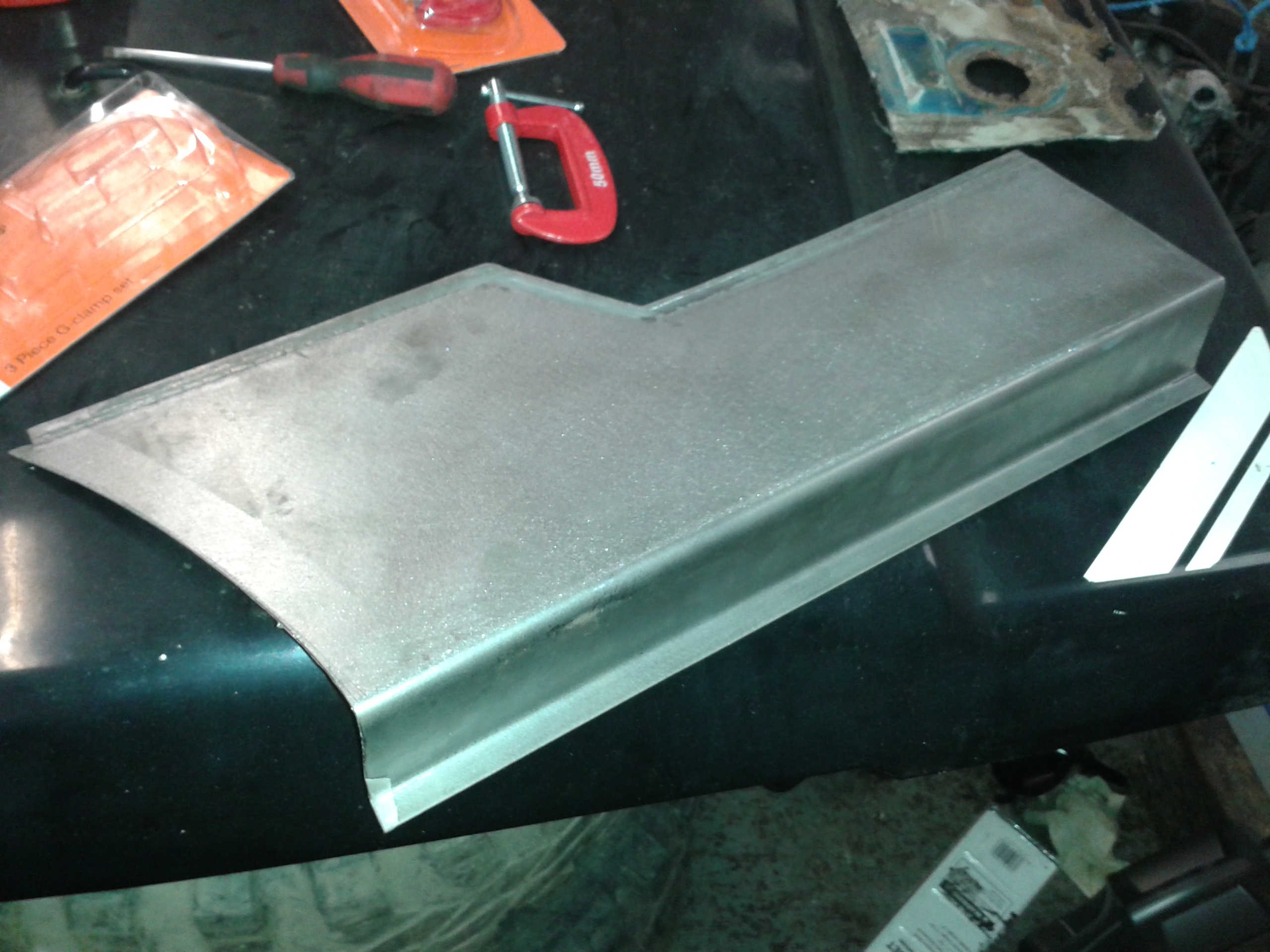

Post by andyrew » Sun Mar 30, 2014 5:28 pm
Thats the one I have.
1.2 is a no go im afraid. 0.9/1mm is okay tho.
If you want nice sharp folds on 1.2 I usually scor the inside of the fold along
The fold line very very lightly.
With a pass of grinder with a 1mm disc.
Ive got a clake hammer and dolly set too. A planishin
Hammer gives a nice straight flat finish.
Below the floor panel is 1.2 inner cill is .9
Re: Sheet steel folder ordered.
Post by donkeychomp » Sun Mar 30, 2014 10:21 pm
Damn that's some fine work there.
