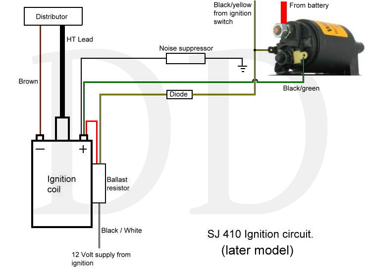

Post by Darrell » Wed Apr 09, 2014 8:02 pm
Some do have a green and black wire as well............
410 later model.jpg (58.13 KiB) Viewed 7053 times
