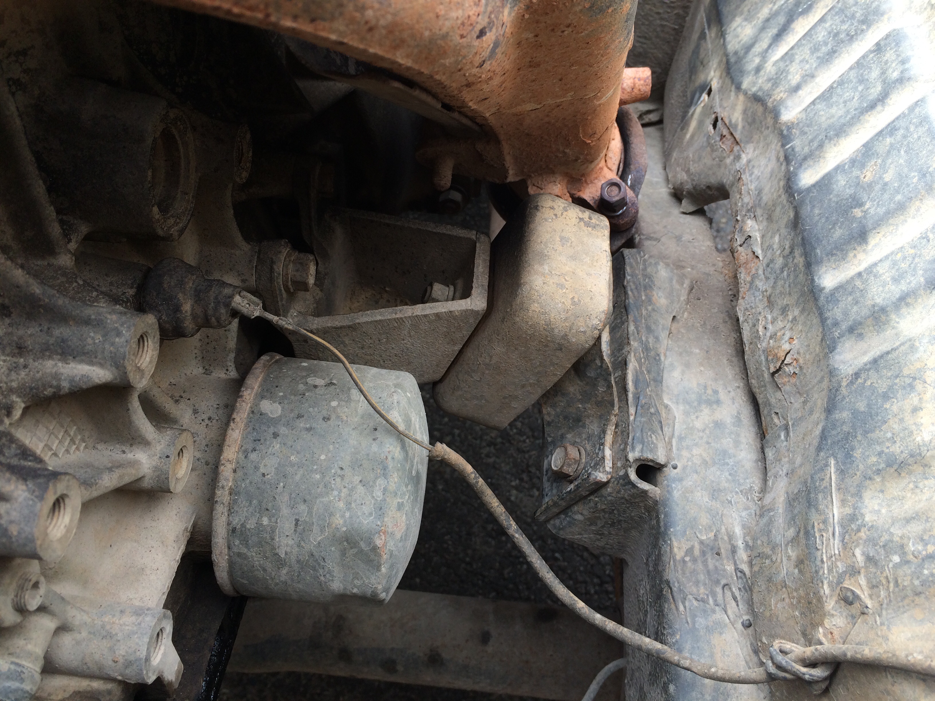

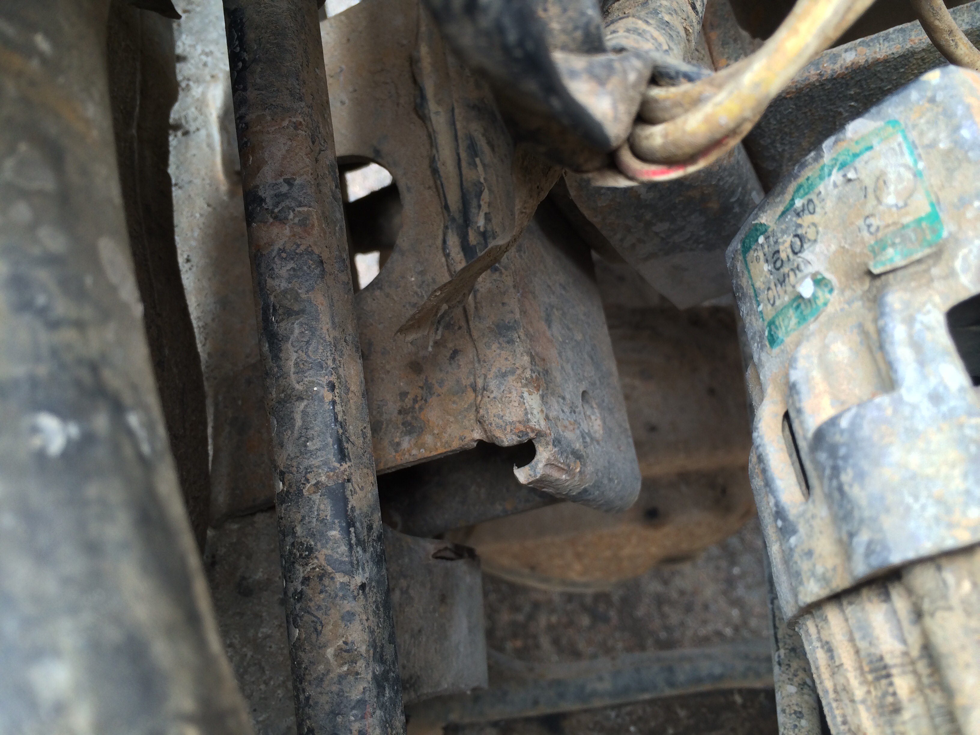

Post by twiss » Thu Sep 04, 2014 1:10 pm
Here's some pic of mine. Excuse the pikey chopped up engine mount

Post by twiss » Thu Sep 04, 2014 2:37 pm
Get some 5mm+ plate and make a couple of spacers for the drivers side

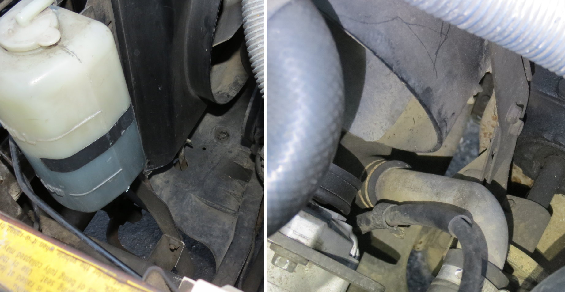

Post by Darrell » Thu Sep 04, 2014 7:51 pm
Been and had a look at mine.
The brackets are on the wrong way around, they should face forward, not towards engine.
Pics to follow..
Not the best photo's , but should do.
Radiator brackets.jpg (235.02 KiB) Viewed 5601 times

Re: Radiator Problem
Post by The Bird Man » Thu Sep 04, 2014 9:48 pm
Now I feel like a right plonker :lol: Cheers Darrell ;) Oh regarding the offset of the engine, with it being 25mm too far to the drivers side, will that matter much ? Might sound stupid.
