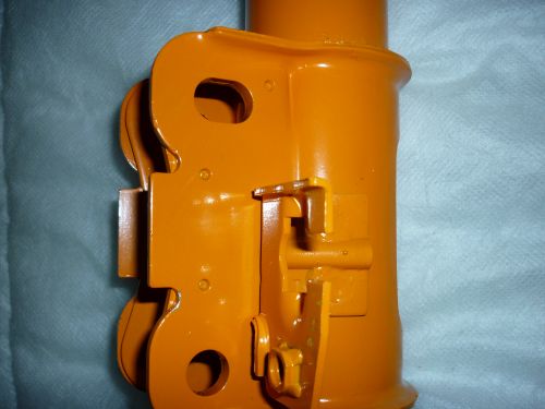

Hi when I replaced my springs and shocks from stanard to OME springs and shocks it gave me two inch lift all round and the camber bolts have not been an issue, mine are just a straight bolt so no ajustment and never had a problem with tracking or tyres

If you have the OME struts then they have camber correction built into the lower mounts.

Hi rhinoman when I did mine it didn't come with any bolts just used the ones that came out and there just straight bolts/ it not scrubbed a tyre since and its been done a few years now.

I think what Rhinoman says is correct. When you buy specific lift kit the strut holes are drilled slightly different to standard so as to correct the camber. This means you can use your standard bolts.
If you just use strut spacers then camber correction bolts are needed.
These still don't cater for the camber on a higher lift.. Having said that I have heard of people fitting
4 camber adjustment bolts.
I can't think what make but some have a slotted hole in the strut so you can adjust to suit.
Not sure how good that would be in the rough IE: would they move/slip.
