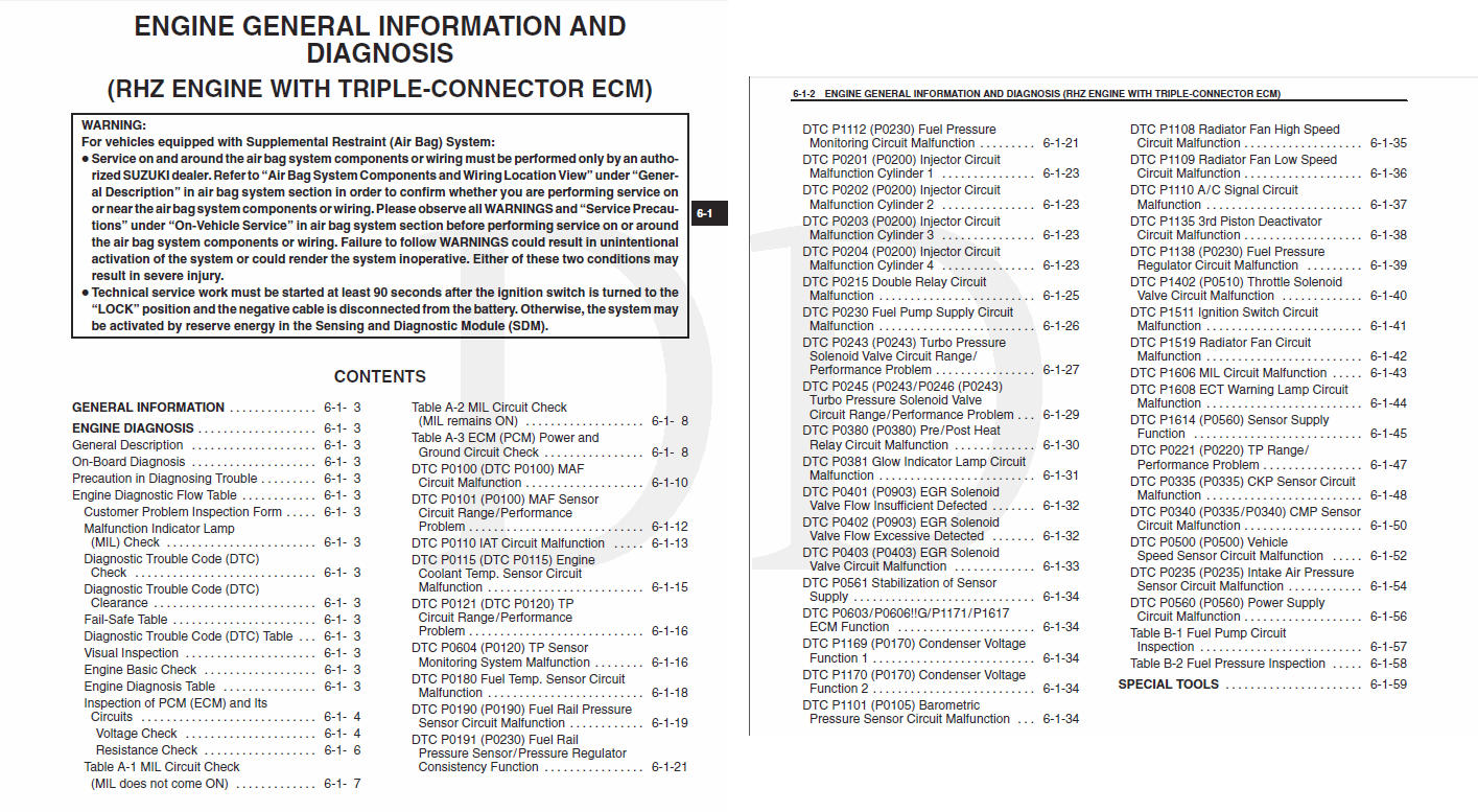

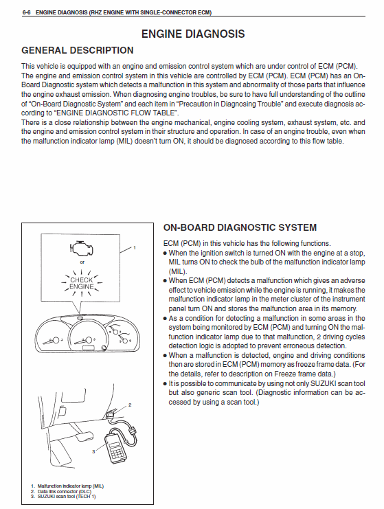

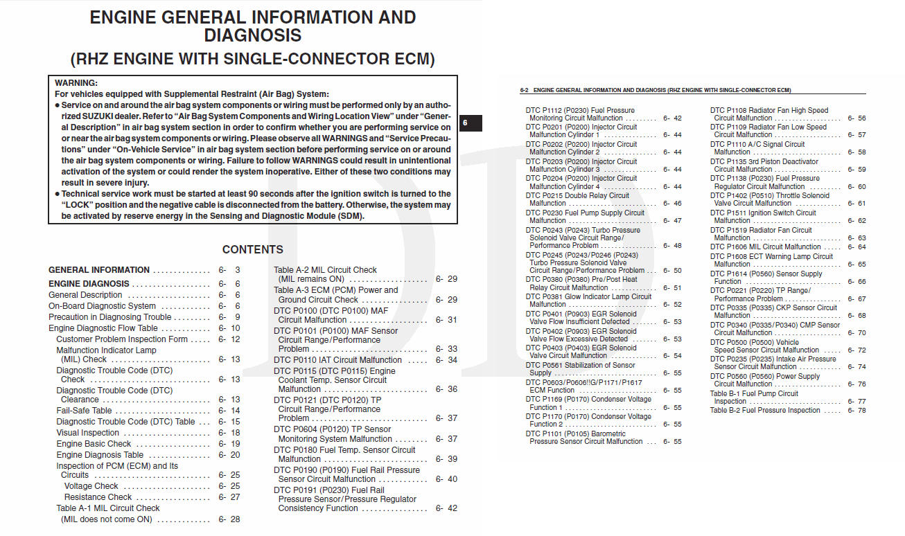

This is from the workshop manual.
RHZ Single connector ECM fault codes.jpg (330.38 KiB) Viewed 7165 times
RHZ Triple connector ECM fault codes.jpg (375.43 KiB) Viewed 7165 times
