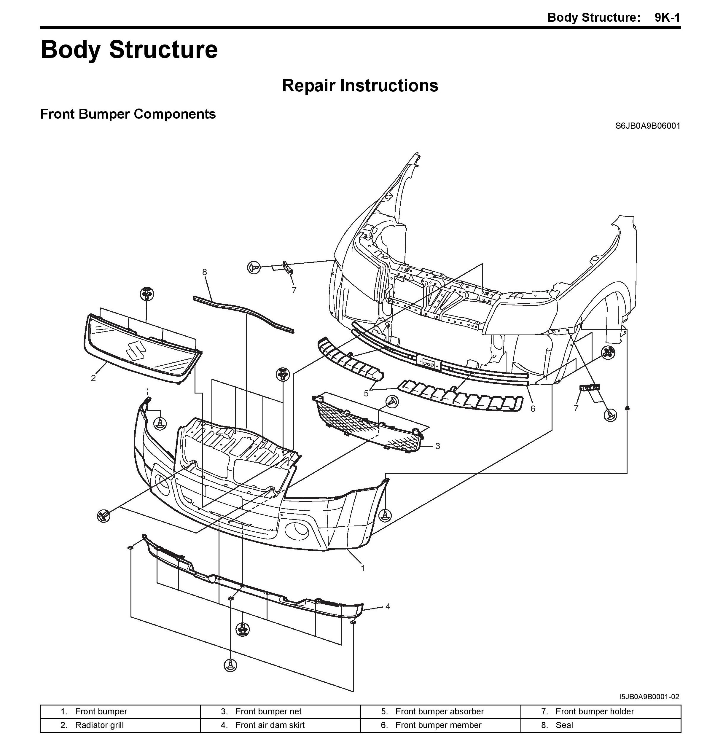

Post by Darrell » Tue Oct 14, 2014 8:24 pm
Hopefully this is correct for yours.

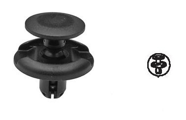

Post by Darrell » Tue Oct 14, 2014 8:42 pm
If your not familiar with these clips, you just need a couple of small screwdrivers to lift the centre pin up to free it (famous last words!!). Much like a screw and rawlplug..
