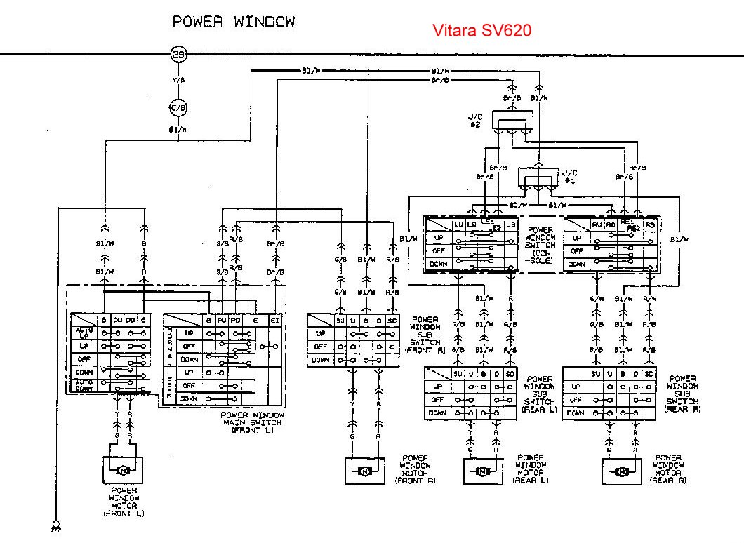

Is that the SV620 ?? 5 door vit the body trim.
Power windows front and back ??
I have a diagram for the se416 but that's only front windows.
Sv620 manual shows 4 doors with auto up/down.
I can crop either from the manuals. :thumbup:

This is from the sv620 workshop manual.
The diagrams are not very good quality but still legible.

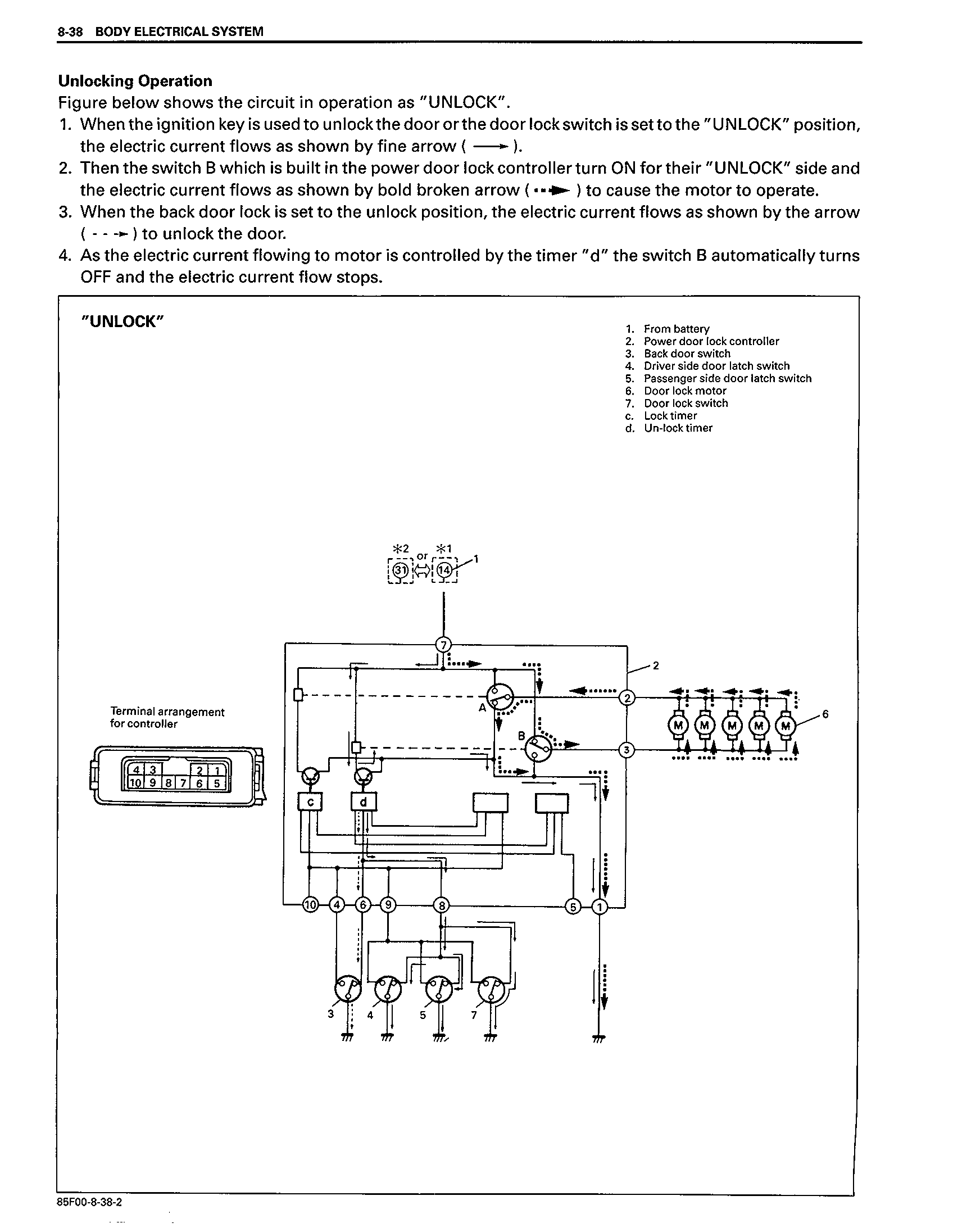

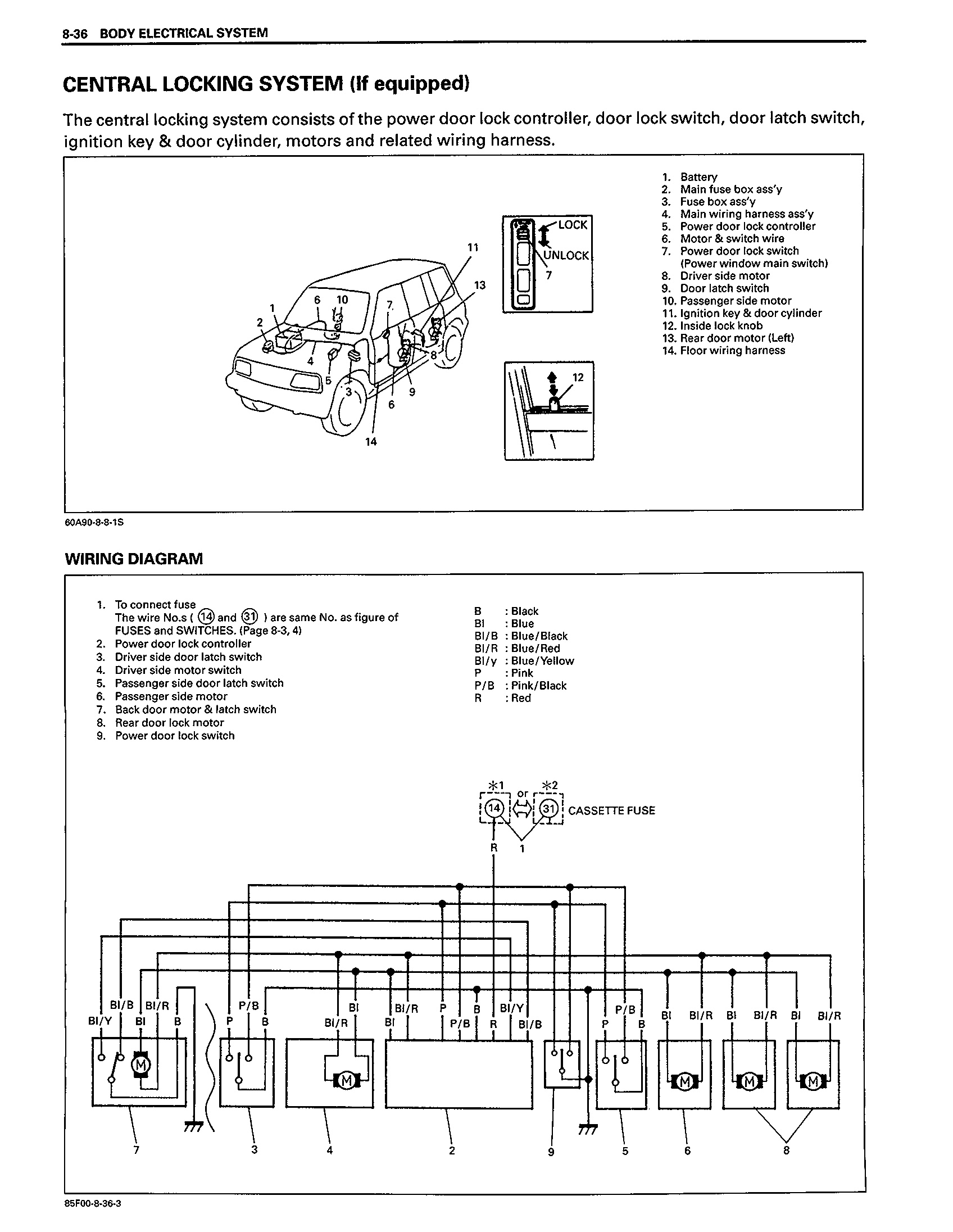

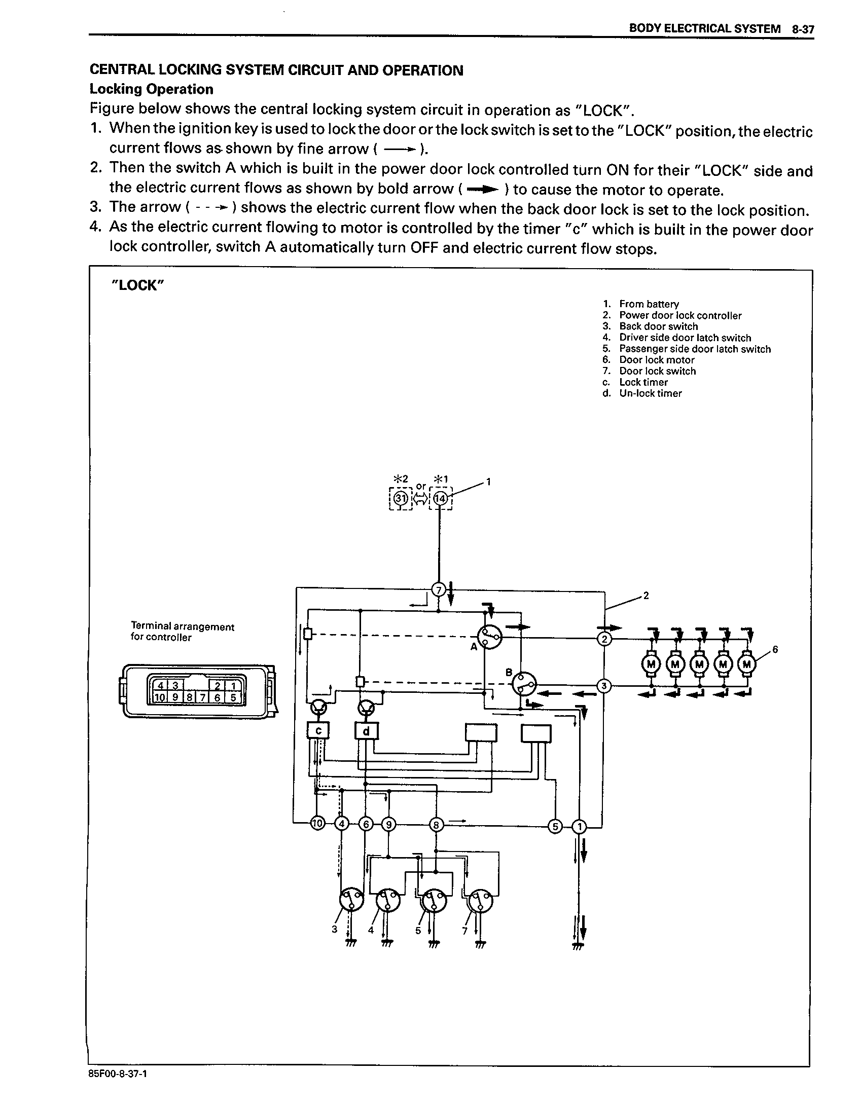

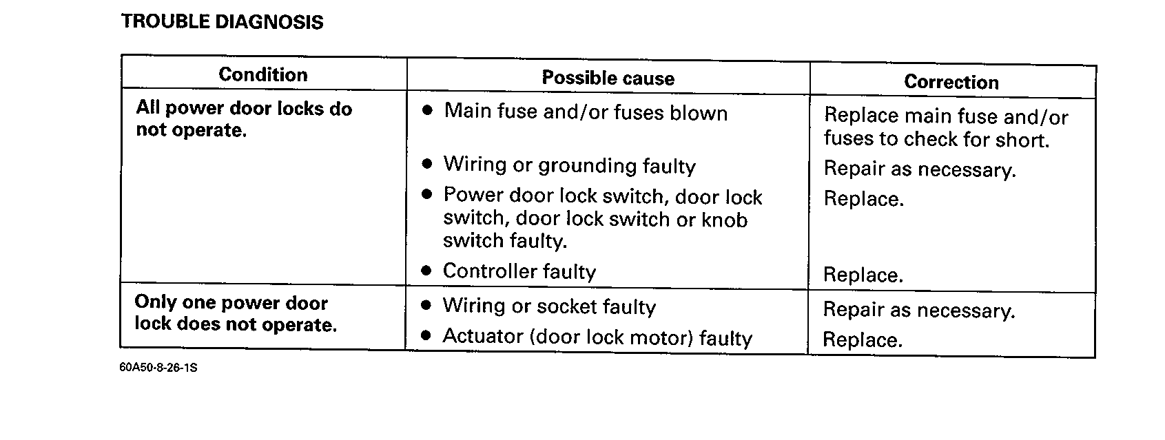

mjm8292 wrote:Thank you, do you have the diagram for the central locking wiring as well please? That'd be a big help :)
Sorry ,I think I'm loosing the plot :D ...Why the hell did I look for the windows diagram :screwy:
Lets try again ;)
sv620 a.png (159.02 KiB) Viewed 7867 times
sv620 b.png (141.65 KiB) Viewed 7867 times
sv620 c.png (135.05 KiB) Viewed 7867 times
sv620 d.png (46.48 KiB) Viewed 7867 times
