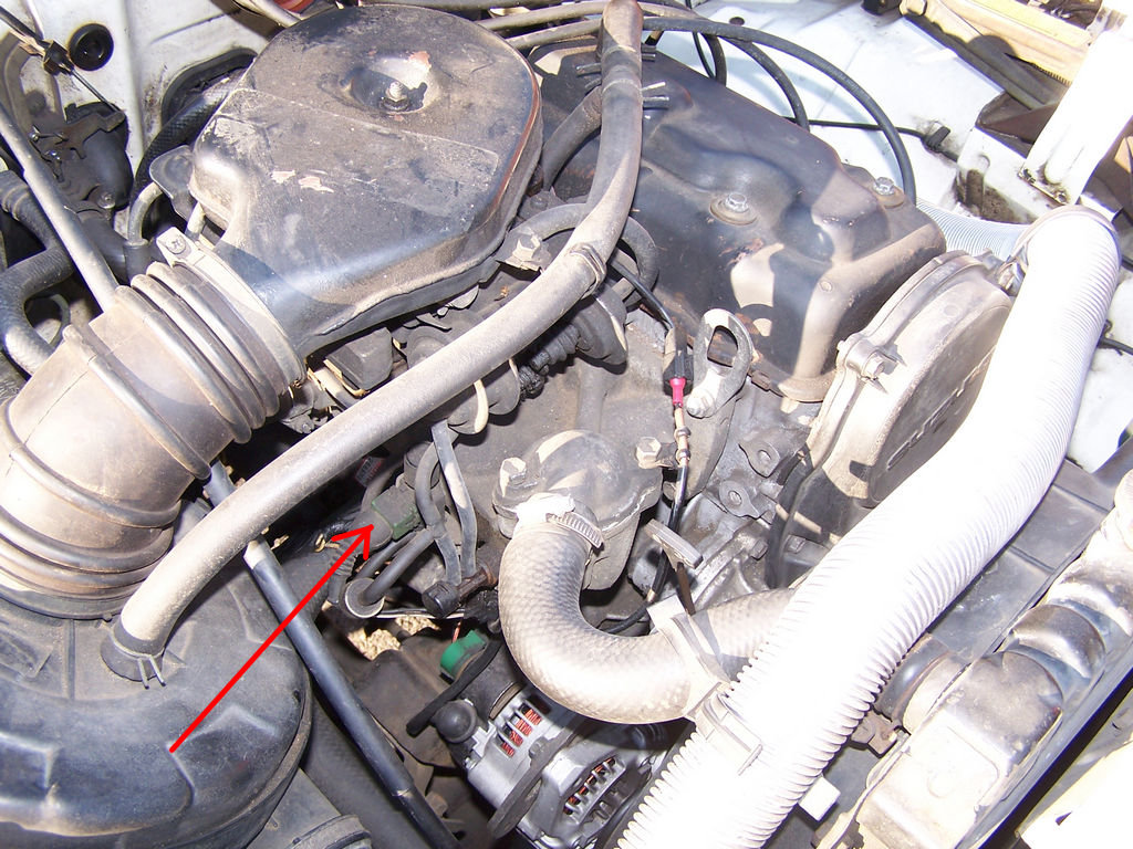

Hi guys just swapped engines on my sj knackered g13B to an ok g13A everything runs as it should,
except when i switch headlights on revs race upto 3000 rpm. any ideas? cheers mike

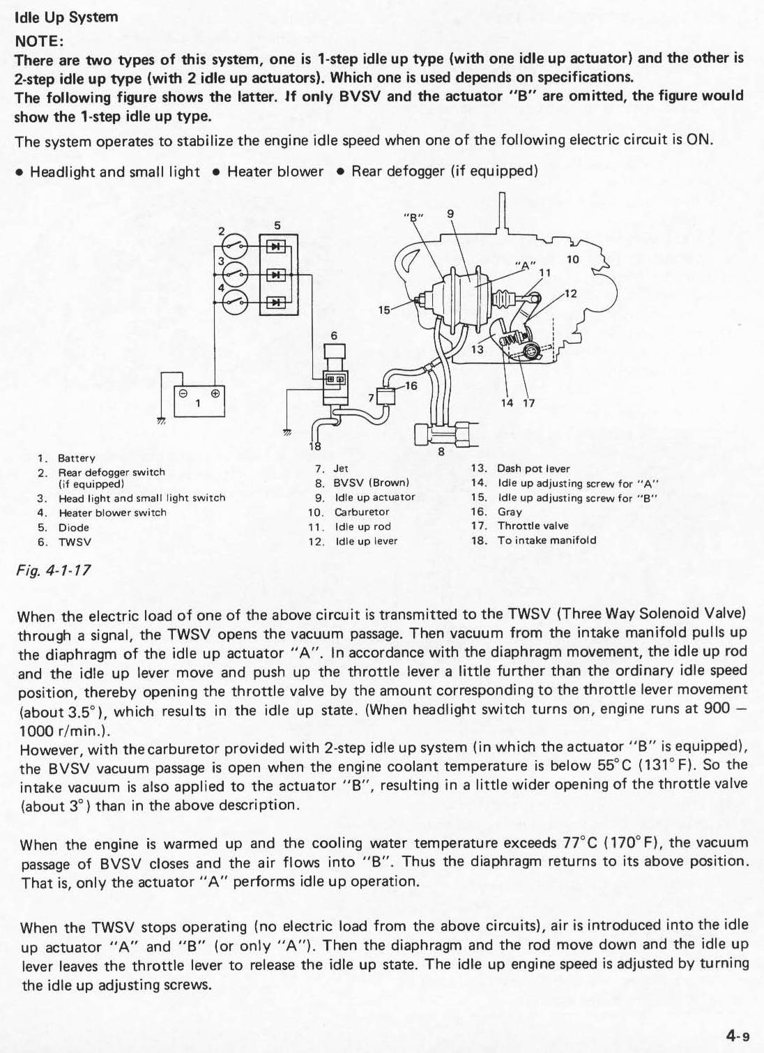

Post by ScottieJ » Thu Oct 30, 2014 7:25 pm
Sounds like the idle up system needs adjusting.

Post by Darrell » Thu Oct 30, 2014 7:38 pm
Welcome to the club :thumbup:
Needs adjusting.....................or just unplug the bugger.

Post by oldskoolsboy » Thu Oct 30, 2014 8:35 pm
cheers guys "removed the bugger" spot on everthing works. MOT tommrow fingers crissed sorry
