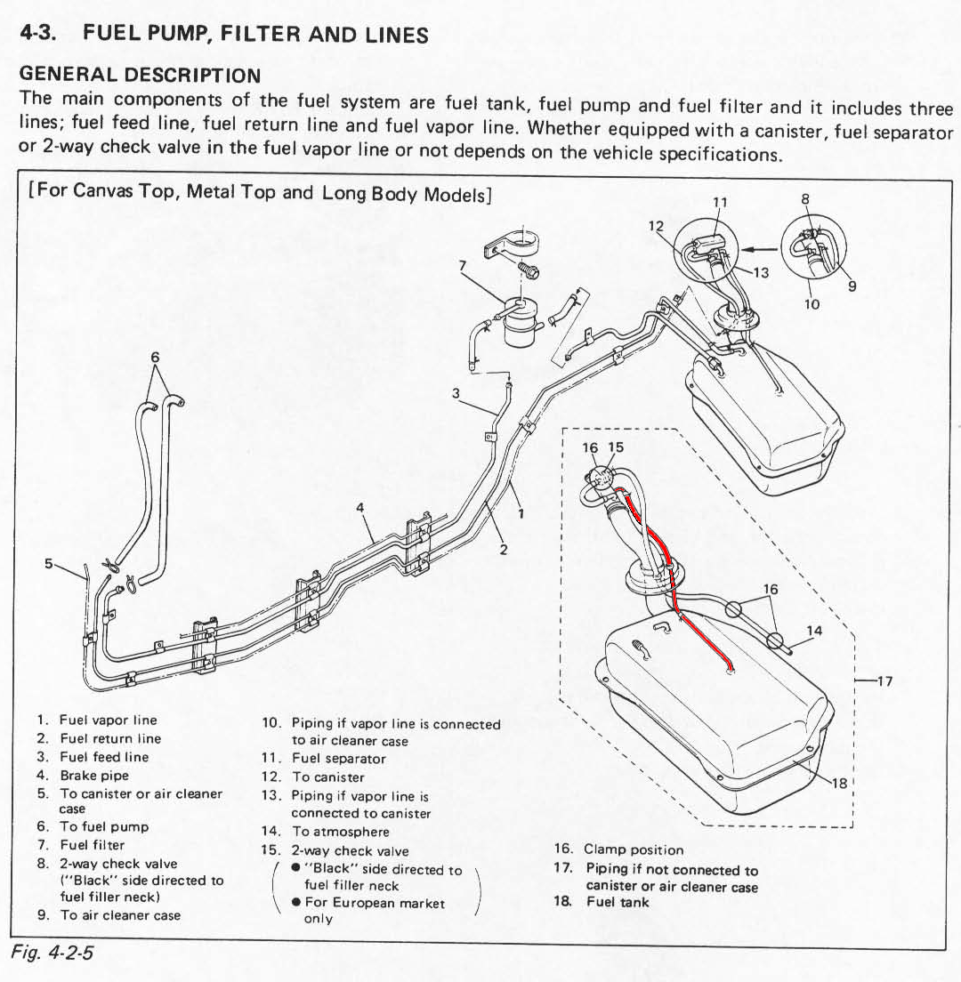

Post by Darrell » Sun Mar 10, 2013 3:52 pm
Had a read of your posts as I thought maybe an airlock, but then thought - no it will just vent via the filler. However not thinking enough about it your right the filler pipe is not on the top and if it can't breathe then that's as far as your going to fill it. Your also correct if you removed the return pipe from the pump it would act as a vent (just for a test fill from a jerry can).
I assume this pipe I have marked in red is just to vent the tank when filling.
What do you guys recon :thumbup:
Re: fuel tank can any 1 help?
Post by Jordi » Sun Mar 10, 2013 7:18 pm
Yup, think thats the main vent darrell. On the tank top there is that vent and a fuel return.
