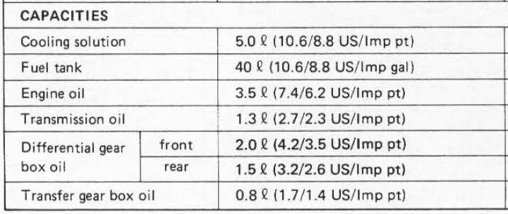

does any1 know how many liters my sj413 should hold as it can be empty and i fill it up but it will only take £20 to fill to brim wich is roughly only 15 liters. and also when its brimmed the fuel gage only says its half full any help would be much appreciated

I think it should hold around 35litres if I remember correctly? Has it been dented as that will reduce the capacity?

Workshop manual says 40l

Basically your fuel gauge or sender or wiring is faulty. When it reads empty you must have half a tank left.

The most likely culprit would be the tank sender but to check this properly you need to remove the tank and then the sender and then check it's resistance values at the appropriate heights/levels.
More work than I could be bothered with as I expected nothing to come undone or snap off.
sender resistances.jpg (71.18 KiB) Viewed 8115 times

Right then, I can only assume half a tank reading is correct. So why can't you get any more fuel than that in it :er:
I can't think of any reason :S :argh:
