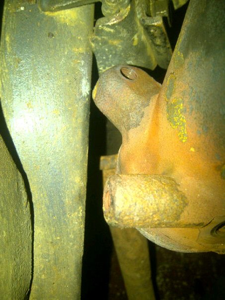

Yep :lol: strange how mine doesn't foul the chassis but the one you had did though?

The 1300 one fouls the block!!!

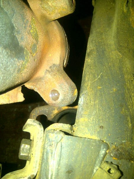

Am I right in thinking there are two different 1.6 manifolds and one hugs the block more. They have different flanges aswell. When I fitted my 1.6 16v I had to move the engine over to the drivers side by 10mm to allow my manifold to clear the chassis rail

gp7186 wrote:Am I right in thinking there are two different 1.6 manifolds and one hugs the block more. They have different flanges aswell. When I fitted my 1.6 16v I had to move the engine over to the drivers side by 10mm to allow my manifold to clear the chassis rail
Have you got the manifold with the single or twin downpipes? Ive got a single pipe one and its pretty tight as well!

Yeah twiss mines the same as yours with the single downpipe It was very close until I fitted a spacer between the engine mount and block

I managed to grind down the flange a little bit on the down pipe, so now it clears OK with no spacer :)
