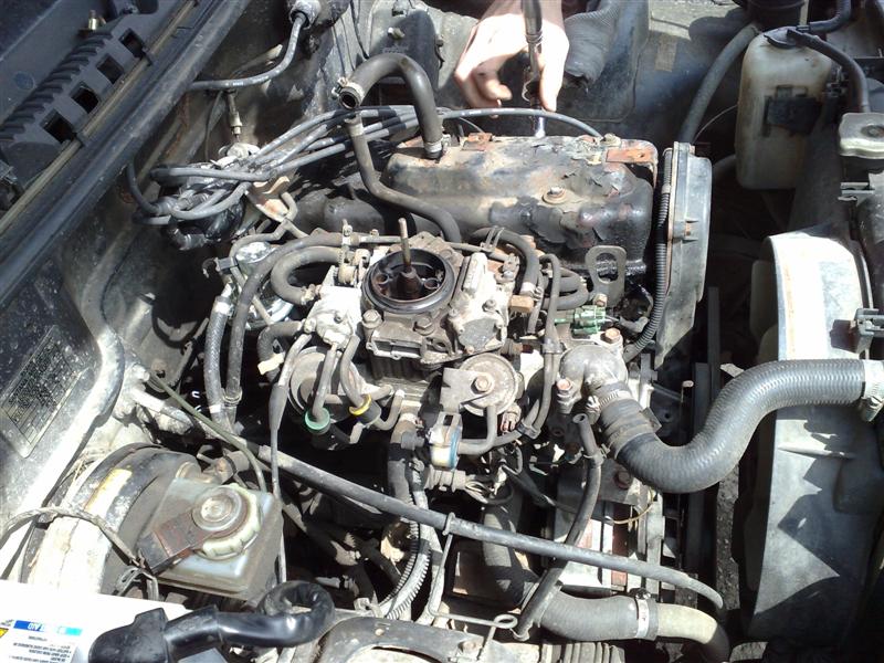

A few pics I found

No idea why the last guy put the return to the carb but thats sorted now lol.
The main pick up is laying over the front and has a small electric inline fuel pump (which u cant see in the pic) Ive removed this hoping that the vacume pump on the engine will work? Unless the 410 have a fuel pump in the tank? Im not to sure?
Thx for the pics btw, great help

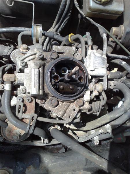

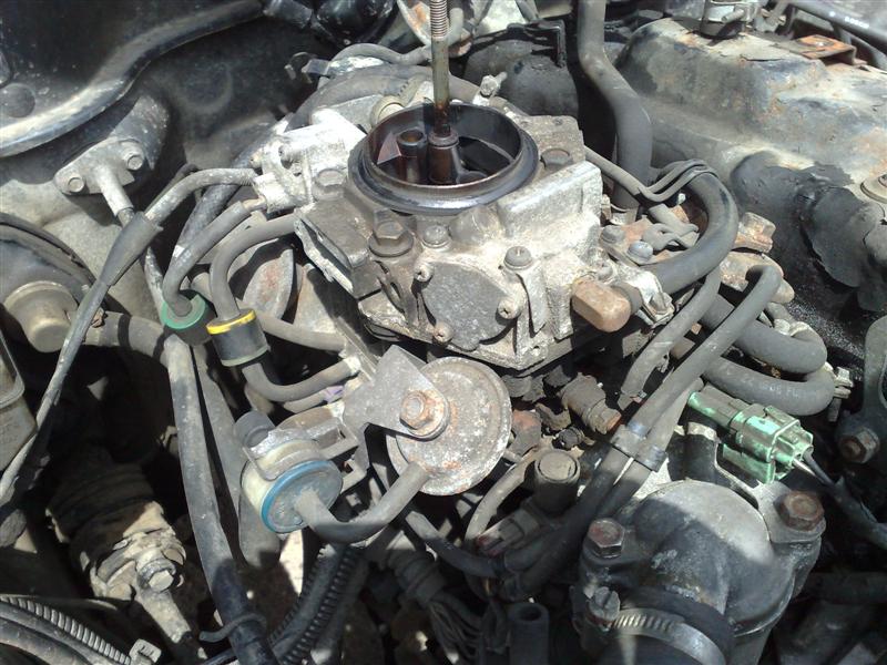

Richie wrote:and again
at the bottom and slightly to the right u see a brown plug. i have nouthing to go into this and the main loom wires have been cut. Any idea what it is and if i need it?
Also right next to it (u cant see in the pic) are 2 plugs, again ive got nouthing to go onto them and have no idea what they are, any ideas? Thx

Thats the idle up system. The SJ also has this system, it's fine to leave it off.
I can check the wires colours if you want to connect it.

"Also right next to it (u cant see in the pic) are 2 plugs, again ive got nouthing to go onto them and have no idea what they are, any ideas? Thx"
In a word ----------
No :D
