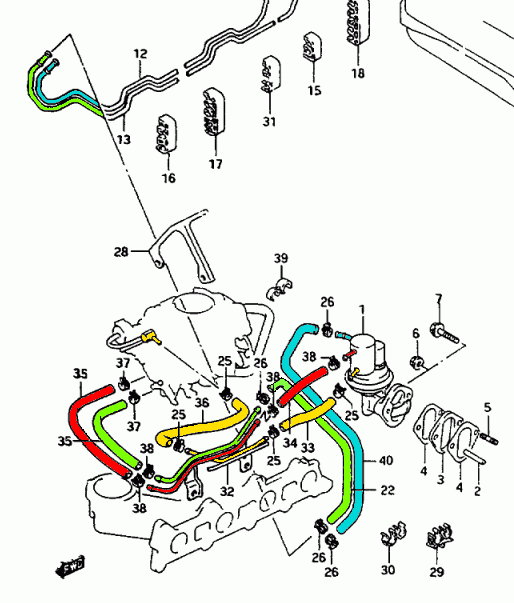

Darrell wrote:Fuel return via the carb is how it's originally plumbed, no idea why ??
I know this is an old topic, but if you can help me with some answers I would be much thankfull.
Where does blue and green marked lines connect to, one is fuel in? which one?
And the two hoses on the top sticking out where do they connect to?
thank you all
Re: G16A engine conversion last snags
Post by Darrell » Tue Dec 02, 2014 7:38 pm
Hopefully this will do....
To answer my above question, this is to cool the carburettor :shock:
vit fuel.jpg (69 KiB) Viewed 8030 times
Green is fuel return.
Blue is fuel in.

"And the two hoses on the top sticking out where do they connect to?"
May need a photo to give us a clue :thumbup:

I used your picture, hope you don't mind.
Need info one the hose with circled in red and the one marked wit green color.
Post by ROBBIE » Wed Dec 03, 2014 8:48 am
Red one should have a T piece connected to the rocker breather and then to the airbox, not sure on the green

Post by Darrell » Wed Dec 03, 2014 7:10 pm
That unit circled green is as it should be. A valve with a small sponge filter on the end. :thumbup:
