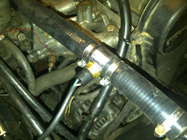

Post by twiss » Fri Mar 28, 2014 2:58 pm
I used one like this... ebay special and used in combination with a relay

Re: radiator problem - fan switch>?
Post by twiss » Fri Mar 28, 2014 11:40 pm
Yeah you want your temp to hover between 80 and 90 thats fine... definitely measure the pipe first
As for the relay, the temp switch will switch the relay on, and the relay switches on the fan motor.
this saves the temp switch from having all the power for the fan put though it
Post by twiss » Sat Mar 29, 2014 5:40 pm
Click Here for Ebay Listing
you will need some wire, a fuse holder and a 30a fuse... and some crimp connectors (ring and spade)
Post by twiss » Sun Mar 30, 2014 10:46 pm
not sure on the TD setup... but possibly not.
You should be able to hear it click and activate when the engine gets to about 90*C, when the fan would usually activate
