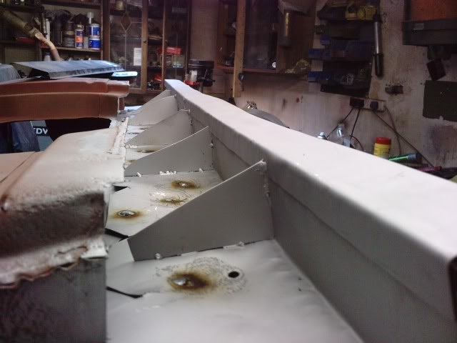

What about tucking the sills like mine?
Box section sills are probably the easiest though.

Yea that looks good! Is the outer the original sill folded under? Or a seperate sheet?
Re: folded sills
Post by ScottieJ » Mon Mar 31, 2014 12:08 am
Outer sill cut off and flipped upside down ;)
I also like this alternative to box section sills, bit more work but more clearance and built in rub rails.

Easy, two L shapes spot welded together (plug weld if you don't have a spot welder)
Simple. Bosh.
