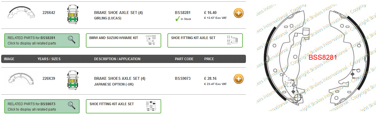

It theory if the axles not been swapped out it should be one of these. The girling set-up is often used on the Spanish built models.
Girling set-up
Girling set-up

It may well be easiest to measure the drum, shoe width and compare the shoes to the pictures.
Brakesinternational has a good site for shoe information/diagrams. http://www.brakesint.co.uk/
