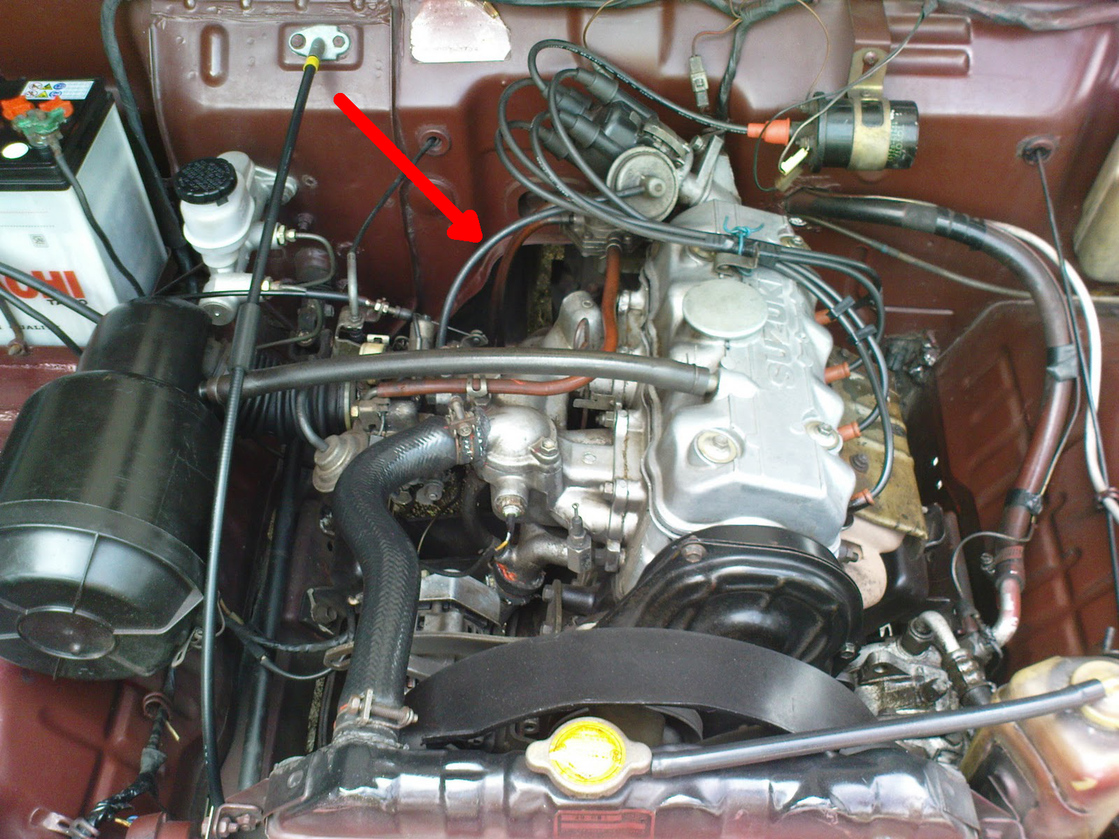

Re: Engine Spluttering
In this pic its the red and black hose marked on there
Deffo haven't got that on mine. Does a 410 have one ?
- twiss
- SCUK Computer Wizard
- Posts: 6111
- Location: Brighton, UK
Ive found a few 410 engine pics and it looks like it should be there... try this
edit: although looking at that it may be a newer/foreign 410 with electronic ignition...
