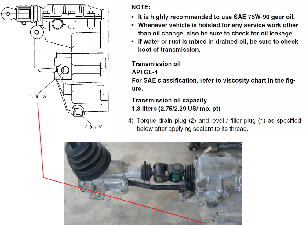

- So I had to do a diagram !!!
- Jimny oil level plug.jpg (139.3 KiB) Viewed 7311 times

I'm not sure if this is exactly the same box, but I think this is the plug in the red circle.
Is it just full of crud in the 3/8" square hole?

I bet that's what it is the square hole is full of gunk, thanks very much for the pics, I think that's going to make it easier, I will try again tomorrow.
Thanks again
