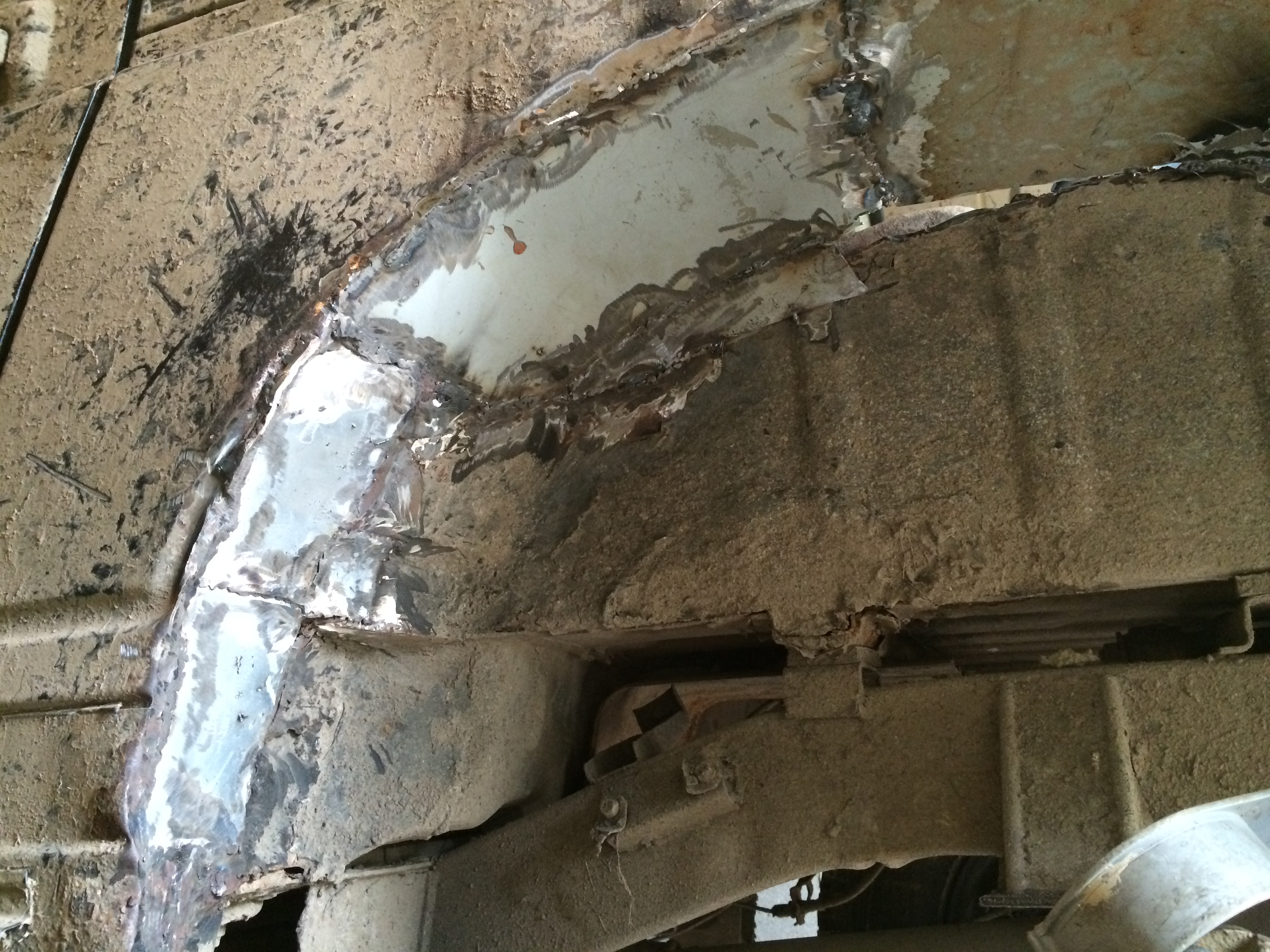

I'd never really welded until a couple of years ago and Ive managed this recently.
If I wasn't quite as lazy and crippled I would probably have it done by now ;)
Im by no means a fabricator so Im sure if you've done some proper welding before you can do better ;)
edit - yes there are some holes in it still lol
