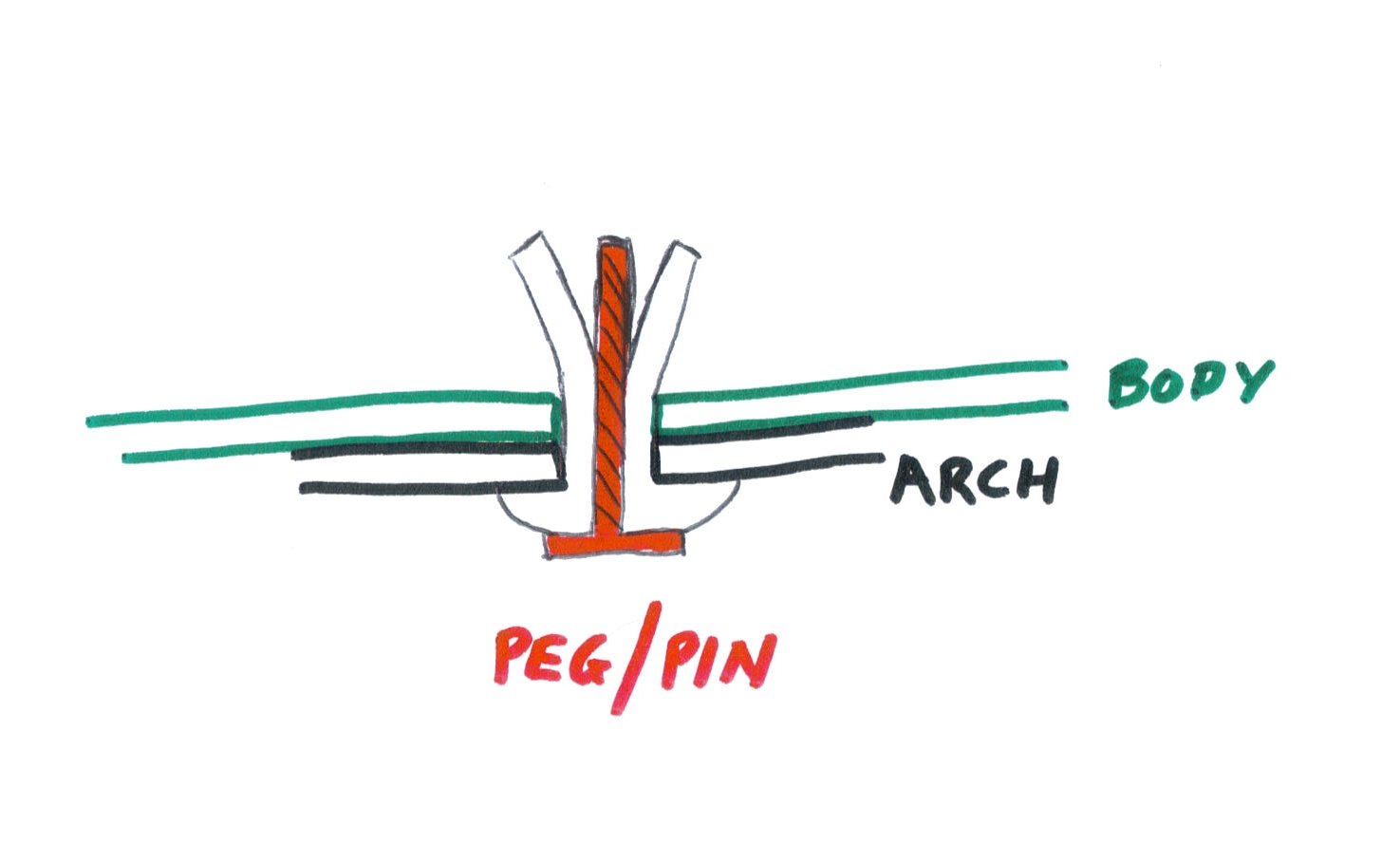

Somebody asked once before and guess what.......
I did a diagram (well sort of ;) )
Arch clips.jpg (60.26 KiB) Viewed 8539 times
I can't remember the diameter though :oops:
Or when they went over to screws :oops:
I must be getting old :thumbdown:

That picture isn't very clear, are they not the type were you push the pin in to release them?

Had a closer look today, not sure what I have got now. They are black plastic and core is plastic BUT has a posi head. Unscrewing does nothing, they just turn. I may resort to just extracing one by any means to see what it is. Seems a fuss over a small fixing but i'll need to get the arches back on one day. I'll extract one and do a pic.

They will the fittings like I linked to on eBay, lots of them do have a posi head on.
You need something strong and thin to get the core out, it's not easy but I've always managed to get most of them out without breaking them.
