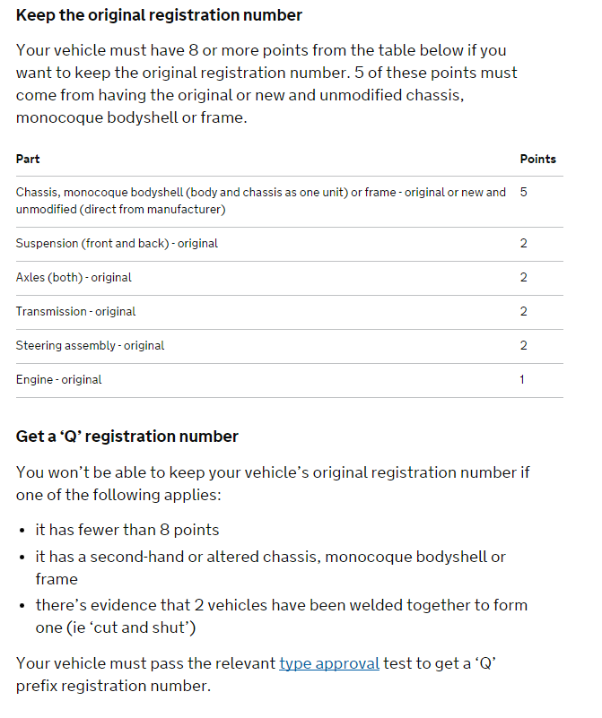

From the DVLA website
I think when you start modifying the chassis it counts as a "radically altered vehicle"
- 2014-10-19 11_47_31-Vehicle registration - GOV.UK - Opera.png (56.05 KiB) Viewed 10159 times

Re: Coil Sprung SJ Chassis
Only if you shorten it or remove a cross brace.
You are free to add cross members or mounting brackets within the original confines of the chassis.
