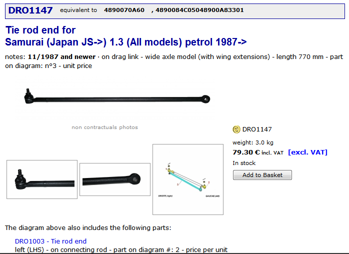

Post by Darrell » Sun Mar 29, 2015 7:27 pm
Only found this
Don't know if it's to the ends or hole/ball-joint centres.
