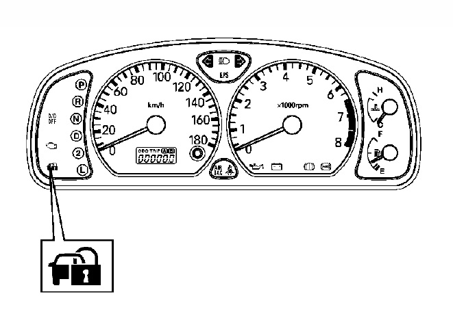

Don't quote me on this, but try another key, I do remember reading this on another forum, turned out to be the immobilizer?

This sign is for the immobilizer on so trying another key (if you have a spare) may possibly work. I'm afraid the mechanic is largely correct, finding an intermittent fault is very hard to find if it didn't store a code. Once it screws up properly then you have something to fix. Hopefully Rhinoman will read this post, if anybody has a clue where to start, it will be him

This is usually a cam or crank sensor fault. The immobiliser is only activated at key on - the light comes on when the ECU believes that the engine is not running.
