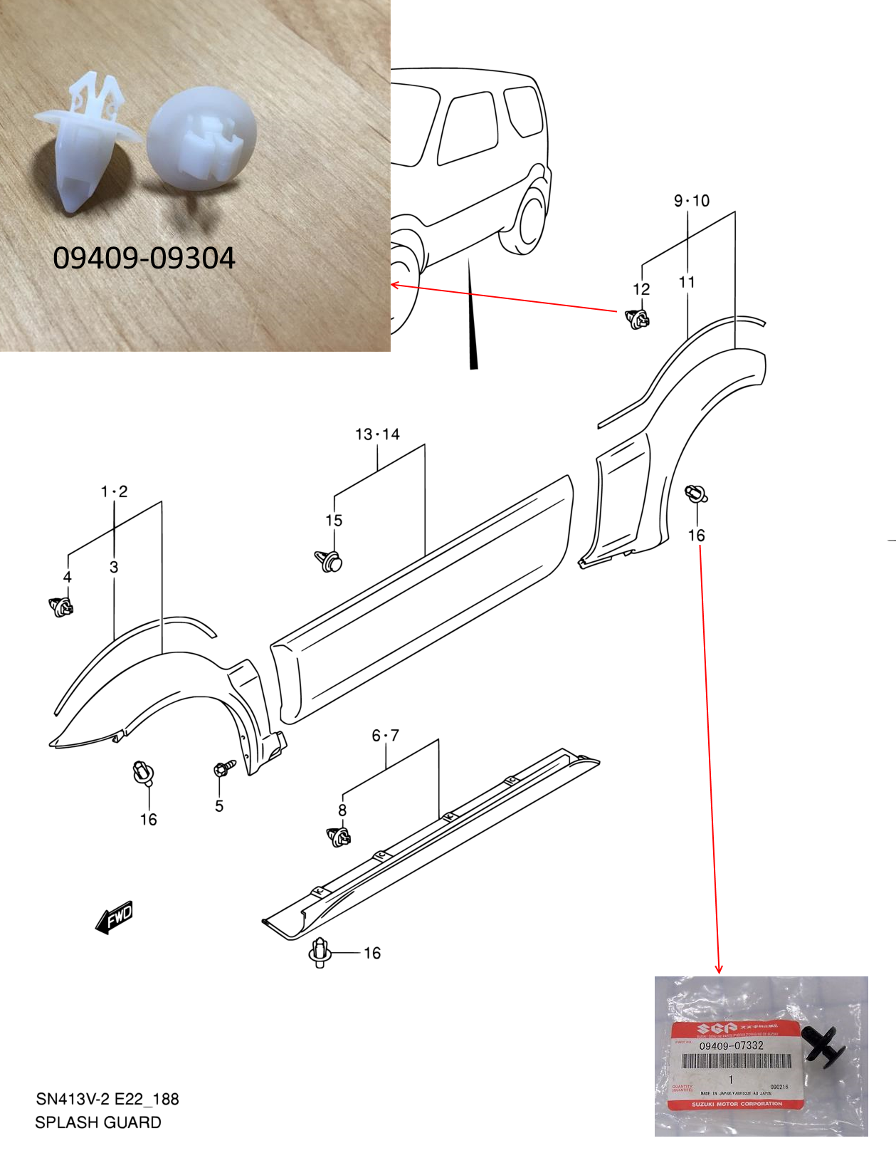

Hi , just purchased wife 04 Jimny 1 owner 18000 miles , nice little motor problem is cosmetic , the old dear before caught plastic trim behind passenger door that starts off about 10inch high and carry's on over wheel arch , ripped and broke several clips , may hold back if I put new clips in , been onto Suzuki and they no help whatsoever , any idea what clips I need , I have to buy online as in hospital , also fuel gauge seems stuck on half , wife filled up and after 2 days went back to half , hardly used it , and on half full when ignition off, sorry for 1st post so long , thank you all.

Suzuki will be able to sort you out with Arch Clips, I think these may fit though
http://www.ebay.co.uk/itm/SUZUKI-PLASTI ... 2111705830

Original or copies can be found on tinternet inc fleabay.
