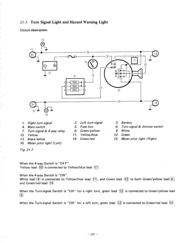

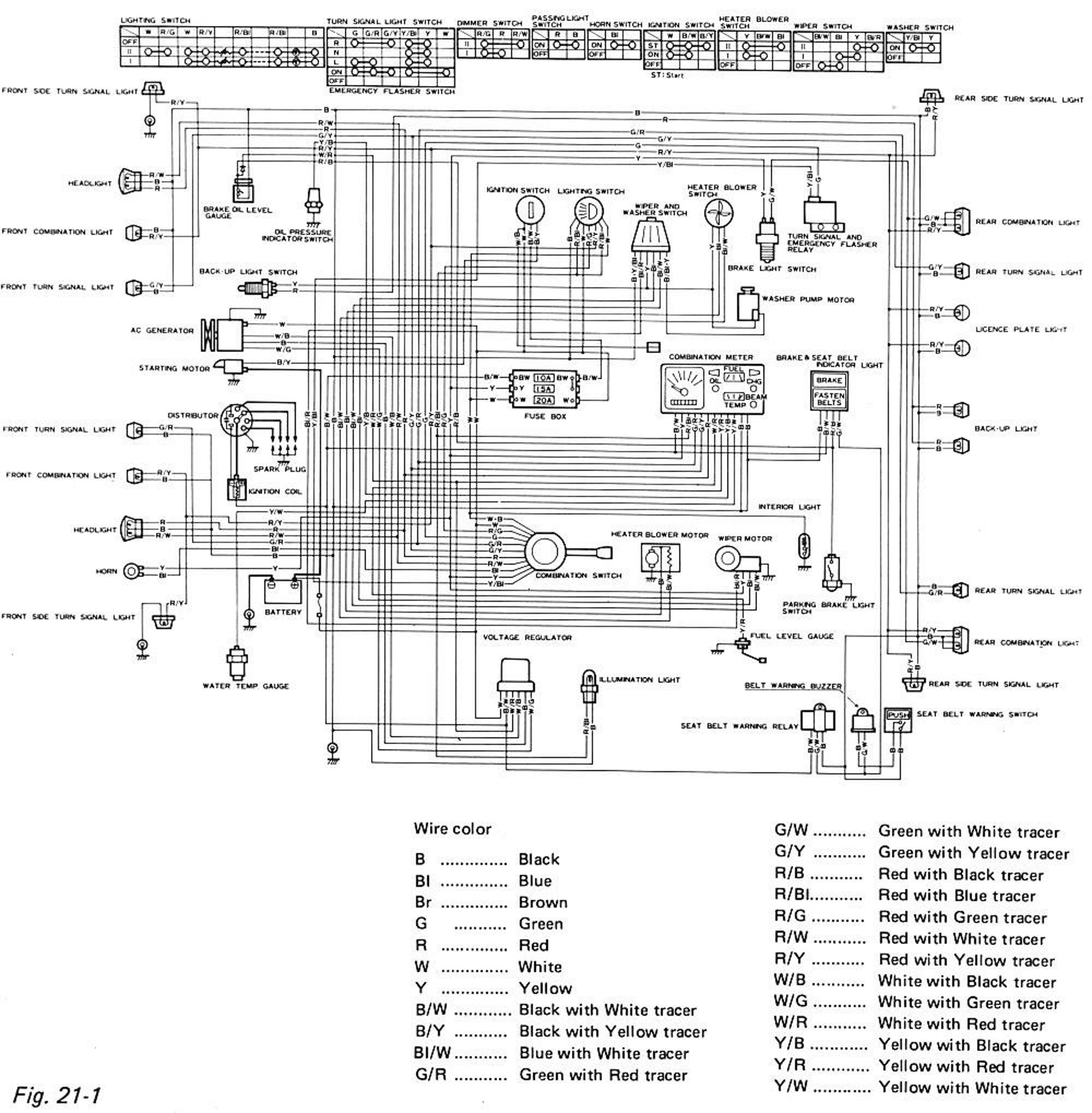

can get all the indicators to work by pull the hazard switch but can@t get them to flash any other way, I think the replacement combination switch is no good so I'll have to re-fit the replacement three way switch the car came with...anyone any ideas how to connect this?
Re: Dip switch location
Post by Darrell » Mon Jun 12, 2017 6:39 pm
Any help..
Post by Pishadeperro » Tue Jun 13, 2017 4:14 pm
many thanks.....I'll give it a go but the prognosis is not good!
