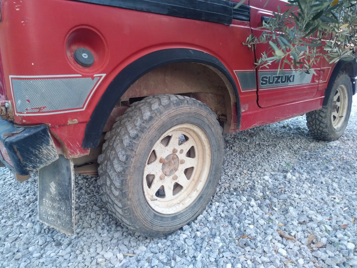

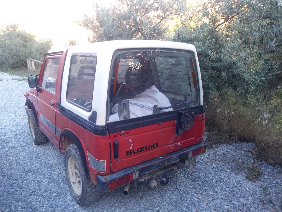

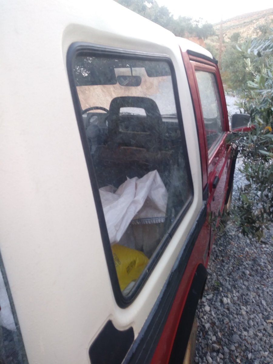

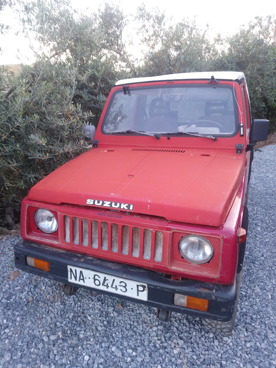

A few pics. Still full of my mates stuff, will get the keys off him soon

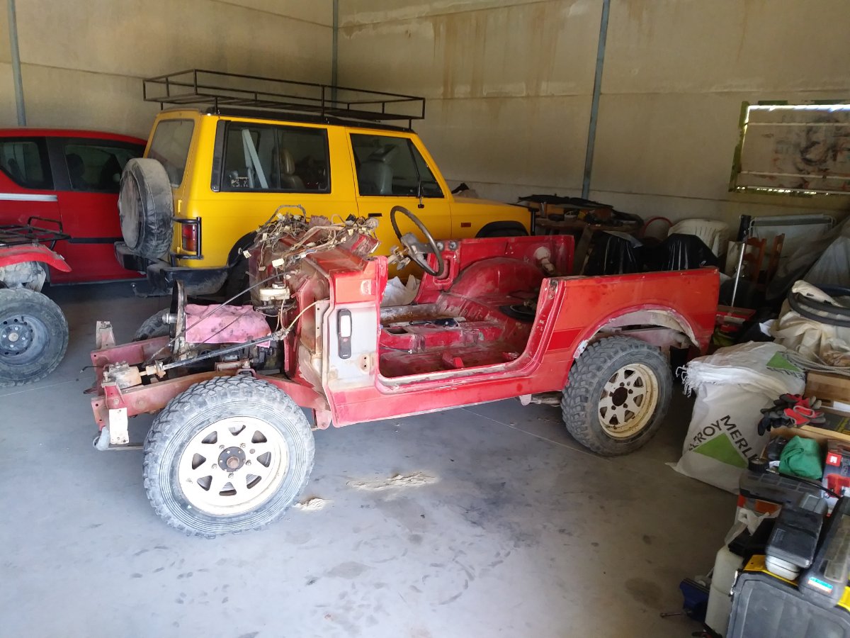

So I got her into my workshop and started off by assessing and obtaining parts, though I didn't do too much stripping down as it took over 9 months to get the documentation, a slightly more complicated matter when dealing with Spaniards as it turns out. Within the year it looked like this ...

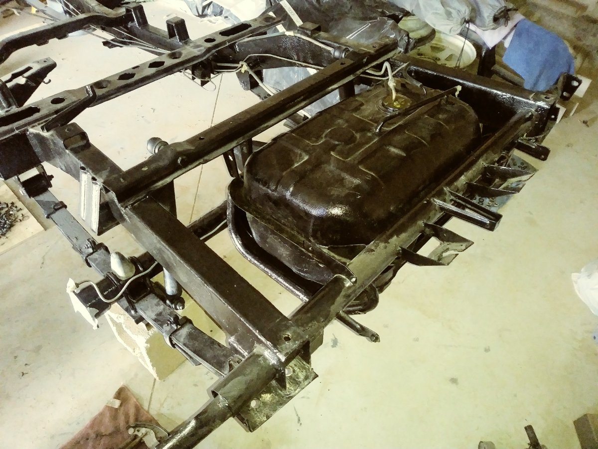

Post by Toodlepip » Sat Oct 07, 2023 8:07 pm

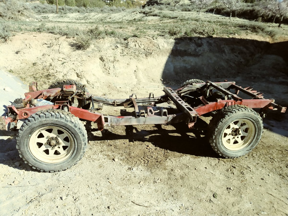

By this point got the body off, all nuts and fasteners removed with minimum of fuss aside from two that required the cobalt drill bits to be dusted off, to say It was pleased with how smoothly it went was an understatement!about 28 months in now, and my parts orders were coming in thick and fast. Every suspension bush was shot, flexible brake lines had definitely seen better days and all fuel/air hoses were ready for the skip.
