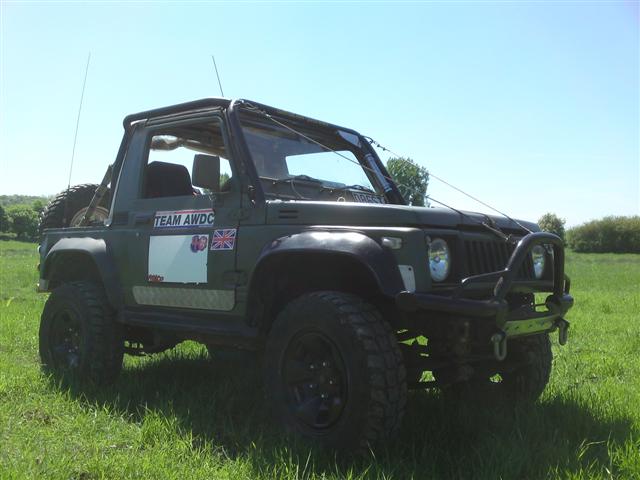

I put some 235/75/15's on my standard sj, and what a difference to the look!
Standard
235/75/15's
Standard
235/75/15's

Thanks for that lesson Luke. Those things can be confusing if you never tackle them.
Mine is all standard, so for the tyres Albert has attached above, I presume new wheels have also to be bought.
Therefore the studs need to align am I right? Or are most wheels standard spacing?
Graham

you should just be able to use the standard 15inch steel wheels.

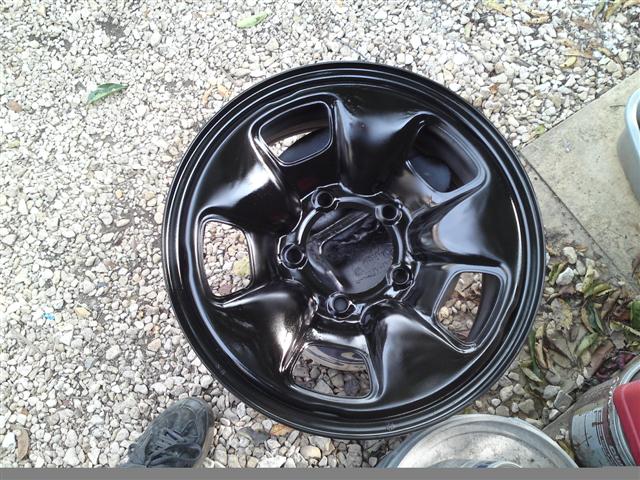

Re: Samurai work
Nothing a bit of paint wont sort out...
My wellers used to be a horrible white...
But a good sand prime and paint made them 100 times better!
